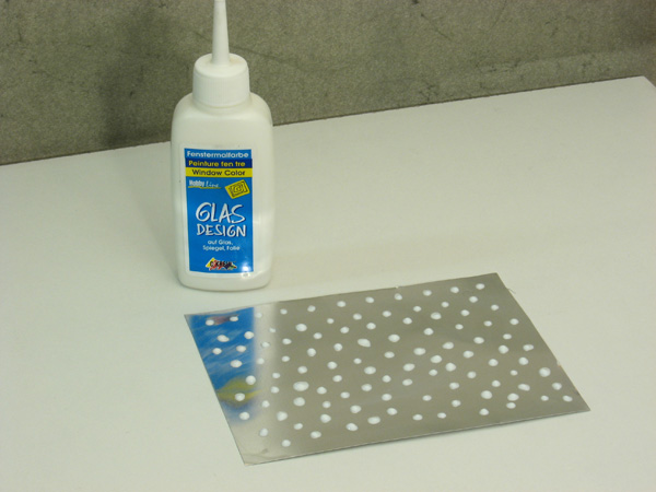

Some years ago I would go with the help of a building from the Internet Hochspannungsbegrasungsger? To build it (This instruction is probably no longer in the network, but there are a few alternative building, or even completed? Te) I use the Ger? Its really rare, because I have never really N with fiber to the landscape design and friends could prefer to work with fine flakes. There is, however, its use in the manufacture of Grass? Scheln.
The principle is relatively simple. I go from an aluminum foil, which I do with a bit of double adhesive tape to fix a board.
http://www.herimo.de/media/Bilder_Grasbueschel/Bueschel1.jpg
When I glue crystal Window Color. It remains flexible after drying, is transparent and has a perfect consistency. The Window Color is 2-5 mm in big drops in on the slide upset.

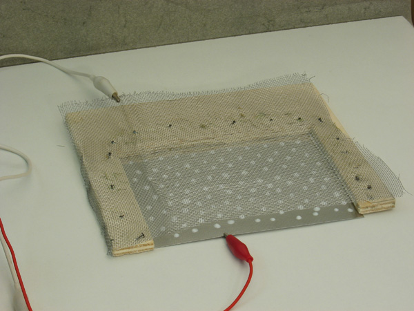

Above the film (about 1 cm distance) will Flyscreens tense. As spacers and clamping frame serves for me a St? Ck plywood. Flyscreens and aluminum foil will work with the Poland of Begrasungsger? Tes connected.
http://www.herimo.de/media/Bilder_Grasbueschel/Bueschel3.jpg
Now I sprinkle long grass fibers (here by the company Heki) in a d? Can layer on the Flyscreens and knock with a wooden rod (Schaschlikspie? O.?.) Fiber through the grid.

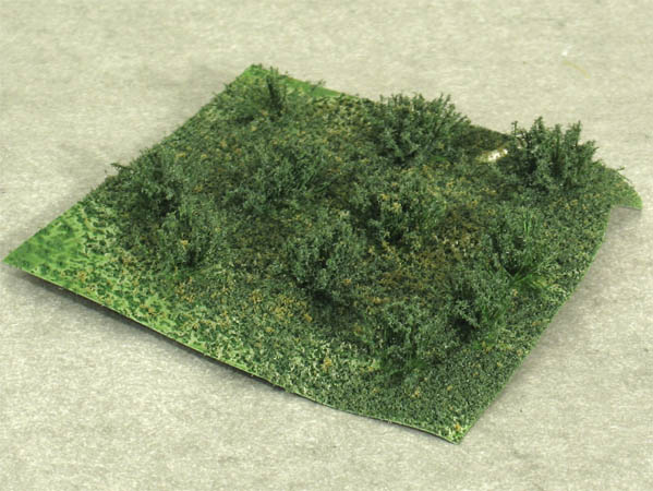

The glue l? T you just attract. Then? The end Begrasungsger? T off the grid and away. In general, the fibers are now fairly tight and upright. If the B? Schel now about the finger? Leads, skip the fibers apart and form halbkugelf? Rings forms.
http://www.herimo.de/media/Bilder_Grasbueschel/Bueschel5.jpg
This Grass? Schel I beflocke or so they have something. F? R flocked the variant are slightly firmer wild grass fibers of Fa still good.
http://www.herimo.de/media/Bilder_Grasbueschel/Bueschel5a.jpg
The Alublech is well manageable St? Cke cut and with green or brown acrylic paint nem eingesp? Ht immediately and with few, very fine flakes strewn. Then? End can again with Spr? Hkleber at the tips colored Bl? Ten afford.
