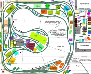

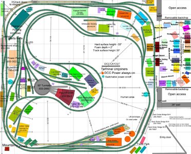

Hey, I'm back. had to take time to plan and go on a 6 day 49 mile backpack trip in wilderness canyons in Utah. Also had to redo my track plan due to getting one huge surprise that I would not have seen had I not ordered a few turnouts.
I discovered upon unpacking some turnouts that some track components listed in the KATO track library in AnyRail must be used with the turnouts and only with the turnouts and thus are not available to use anywhere else due to their design of the molded ballast roadbed. In my original plan, since I was not aware of this issue, I used those turnout accessory pieces many other places in my track plan. Unless a user wants to take a Dremel tool to other track pieces to modify them to fit, these specific accessory track pieces are the only way one can connect regular track pieces to the turnouts.
This was extremely frustrating for me, I was angry that this crucial information wasn't addressed by AnyRail. I had to remove these specialized accessory pieces from my track plan, which made the plan look like the old pick-up sticks I played with when I was a child, toss them in the air and see where they all randomly land. That is what my layout then resembled. Just a bunch of disconnected track laying about randomly! Had I waited to order KATO turnouts until I had the benchwork built around the perimeter of the room, I would have had an expensive re-work to do. It took many many hours to rebuild my layout plan with the correct unique turnout accessory pieces incorporated to each of the 37 turnouts, and to redo the plan with the common track elements to once again make it a workable layout. I did test runs of my locomotives and longest rolling stock on the temporary benchwork track and no problems, even at a fast speed.
With all that said though, I really do like the AnyRail software, finding it very valuable for designing a layout, easy to use, and it beats paper and pencil! I especially like being able to run the layout through it's paces in TrainPlayer software, which catches any track connection errors in the plan. So I do highly recommend AnyRail
I strongly recommend the software designers add some notes to the item description one sees in the item's tooltip and on the status bar, when the mouse pointer is placed over a track segment in the KATO HO track library.
So I now have my track plan in it's final form. I have built a mock-up benchwork in the spare room to make sure that it all fits and the space for this human being to move around also works, which it does, as long as I don't gain many more inches to my waistline! Next is to repaint the room, and then build the valance to hold the LED light strips, and then the permanent benchwork. Here is my layout. Comments and critiques are still welcome. Thanks to all those in this forum and others that gave me alot of valuable input.

Re, those S-curves: Connecting curves that turn in opposite directions directly end-to-end is almost a guaranteed spot for derailments, although you might get away with them at very slow speeds. Author Paul Mallery (old school track and bridge expert, and author of at least three books on those subjects) opined an acceptable alternative is to insert a length of straight track in between circular curves. He suggests a length equal to the longest equipment you plan to run.
You have obviously taken this to heart already, as you had several of those problem areas in your first plan, but seem to have fixed them in the second plan. Your friend did give you good advice and you took it. Well done.

Just, curious. Why do you like that suggestion? Seems to me to limit the operation at every industry to the same basic move. Back in, pull old cars out, push new cars in. Am I missing something?

Iron Horseman...I did turnouts facing one direction to make it easier to pick up and deliver cars without having to use runaround tracks so much and in the tight space I have to work with it just made placing industries easier. Real railroads prefer spurs to all face the same way, making operations more efficient, less time involved, more economical, and safer. Lance Mindheim covers this quite well in his book 'How to Design a Model Railroad'. I will run trains in both directions, so more complicated switching will then be needed. I will have three or four strategically placed switcher engines to help so a train can be broken anywhere and then a car switched in or out using the switcher, while keeping the locomotive and cars idling on the mainline, and then connecting up again before moving on.

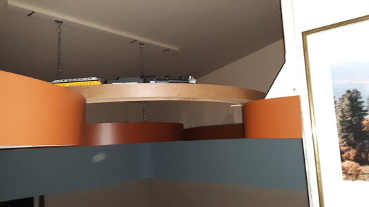

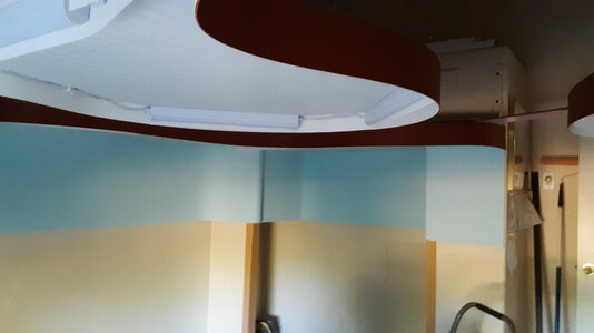

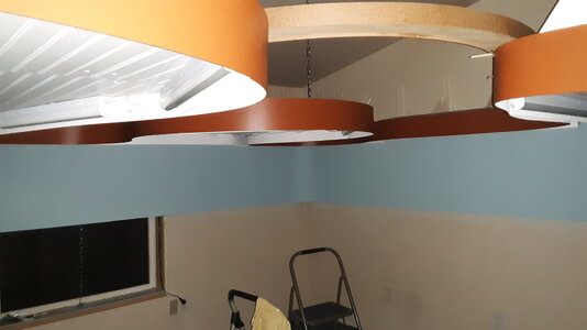

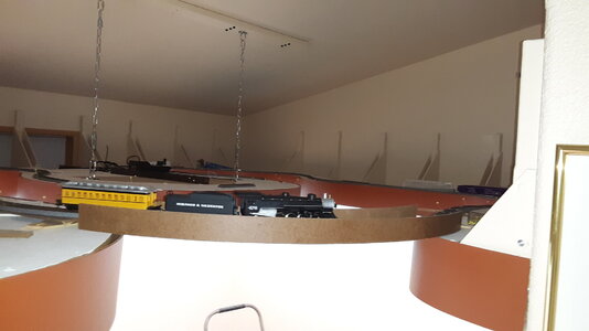

Here is a progress report on my new HO layout. I have just finished the lighting valance, with all the LED lighting installed. All the LED lighting only draws one amp!. The blue backdrop with have clouds painted onto it by an artist friend of mine. For railfaning effect, I am adding a train on the lighting valance that I can let run continuously whenever I am in the room. It is an steam engine and passenger cars labeled as the 'Durango and Silverton Narrow Gauge Railroad'. Since I live in the Durango Colorado area, and that is our local tourist railroad, I wanted that to be what I see and hear as I build out my layout! Next step after the clouds are finished is to tear up the worn carpeting and install a new Pergo laminate floor which I have on order from Home Depot. Now I'll take a break and go camping!
