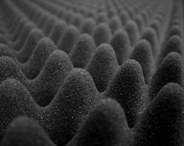

Probably more effective than carpet, and possibly cheaper, would be egg crate material.
It can be easily attached to the wall under the table, the underside of the table, and the ceiling.
You might even be able to find it in a pale blue for the ceiling. Though I imagine the grays would be good for under the layout.
http://www.onlinefabricstore.net/fo...els/3-54-54-acoustic-egg-crate-foam-blue-.htm
If you really wanted to go nuts with it you could get the big triangular stuff, but I can't imagine it really being that much better than egg crate, and it'd look pretty weird and take up a lot of space.

Regarding the egg crate foam, I already have what would be six 2' square pieces (from three seat cushions I replaced) I already tried. It did some, but didn't seem enough.

Back in the day, when a friend had a king-hell stereo system (dollar-wise, not loudness-wise), he used to put blocks or pyramids of foam rubber in various places around the room. Stuff looked like the eggcrate material above.
Not being an audiophile, I have no idea if it really helped or if it just made him feel better about the acoustics.
The egg crate material was used in many recording studios to get rid of the live-ness in a room. You would need to cover 3 walls and the ceiling to do it right. I would put dense items near inside corners to get rid of standing waves which made the deep bass muddy. Sound deadening and getting proper acoustics are really 2 different things.
