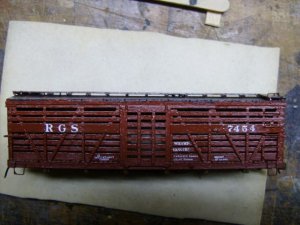

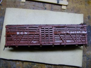

Here is a couple photos of the Sn3 P-B-L Stock Car kit I've been working on. This is the two sides, painted Special Oxide Red with a squirt of Gloss Coat on it, so I can put on the decals. The Road Number is made up from individual number as my choices where 7451 to 7474. I chose 7454 for no other reason than the 4 and 5 where right together. I'm putting the RGS and Road Number in the upper right corner on the ends at this time. When I get those done I will maybe weather the car some. After my confusion with the instructions, the car is coming together nicely!

What gauge track are you going to use? According to Google, "S" gauge being 1:64, Sn3 or 36" works out to .562-3" or 14.28-14.3mm depending on reference. The nearest commercial track would be 12mm, so a tad narrower. Or, do you intend to handlay to that 14.3mm ?
{In the Case of "S" Scale, the proportion is 1:64 or 3/16" equals 1 foot. Standard "S" gauge is 7/8". Three foot gauge in "S" Scale (Sn3 gauge) is 14.28 mm (0.562 in).}
Toot, The model is a Rio Grande Southern Sn3 gauge Stock Car, the RGS was a Colorado Narrow Gauge line. The reason I am building it was to give me something I can hold in my hand, look at, admire and compare with my HO stuff, to see if I really want to scrap what I've built so far and go Whole Hog into Sn3. The jury is still out. Were I to build an Sn3 layout, I would hand lay all my track. However, commercial track is available in Sn3 gauge along with turnouts. P-B-L sells Sn3 Flex Track in Code 70 and 55. They also sell Turn-Outs for Sn3 #6 left and right hand in Code 70 and 55.

I have put on the decals on my Sn3 Stock Car and I think the car turned out respectable. When I am completely done with it I will take a batch of photos.
