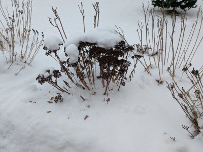

I’ve been wanting (needing) to add more trees and have been scouting around for suitable material while out walking the dogs. The other day as I was at the front door it occurred to me that the answer was here all along! The wife’s flower garden is full of Sedum, similar to Golden Rod but with a much “barkier” looking stem.

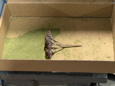

I cut off a few pieces, plucked a few leaves, then sprayed them with tacky glue before a dunk into some ground foam.
I was so pleased with the results I went out and cut down a forest worth!
Going to have to blame it on the deer come spring… lol
Sedum in the garden:
A cut off piece in the ground foam box, I apply light green on top and a darker green under to create a shaded look:

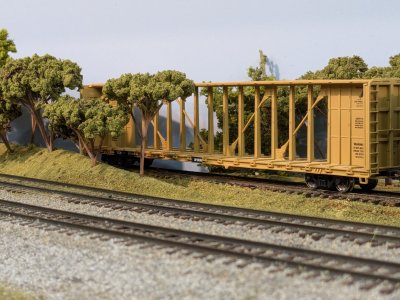

On the layout disguising the dead end interchange:

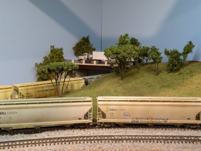

Hiding the end of track at the mill:
They look really good, and very convincing! The price seems right too!
Isn't that all Supertrees from Scenic express are? Just some plant that they collect and throw it in a box, and re-sell for tree armatures.
How many can you harvest off of a plant?
Yes supertrees are just another type of plant, Seafoam maybe?
I get five to six trees per stem and the plants have about a dozen stems in a cluster.

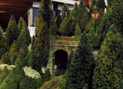

Those do look good. I make my evergreens starting with the cheap Christmas village trees, then spraying them with green paint. While still wet cover with ground foam. Aft that dries spray with clear matt (or hair spray) and add scenic grass for needles and a little orange or yellow Woodland Scenics flowers for some color.

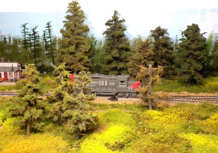

And the large fir depicted in this image is homemade with scraped and painted dowel and natural fiber furnace filter:
index.php
