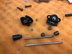

^^^ That, Ive done a lot of DCC Rivs and the best thing you can do it take out that old 3 pole motor. Its a power hog with really really bad slow speed capability. While your at it install a longer shaft in the first tower gear to give yourself more drive shaft to connect 1.jpg2.jpg too.
I agree with MikeMims about motor replacement. I put a can motor in mine and added pickups to the tender. My version did not use the tender for pickups. These upgrades made a real smooth running machine.
