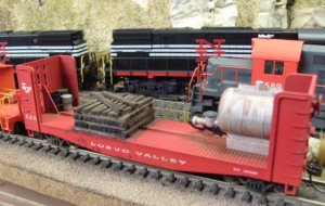

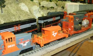

I converted an old Athearn bulkhead flat into a MOW car for track crews. A few barrels at one end held in place with chain. The ties of course and a tank with a coiled hose for weed killer or other liquids needed along the track.

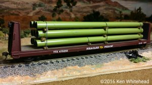

Ambroid bulkheads
These were originally pulpwood flats (Ambroid) but I modified the build to make them simple bulkheads which were more practical for my layout. I eliminated the center bulkhead and replaced the screen flooring with decking. Just this past weekend I added a pipe load.
492.3 KB
an easy way to convert the deck to one more appropriate for a typical bulkhead (as opposed to a sloped one for pulpwood) is to use Evergreen styrene sheet that has the 'wood' boards molded in. Cut to fit, paint and viola! Wood decking. This is the other Ambroid flat, this one with drill pipe load; it's a bit easier to see the decking here.
