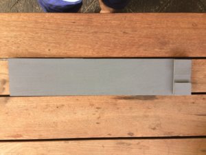

I have gone for 3 ply base, here is the start after priming. Is there a way of getting the wood grain out, I thought maybe using a water down wood putty but I'm, not sure.
Cheers

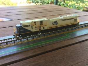

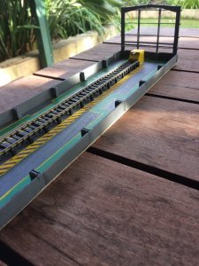

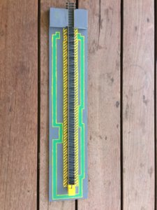

Started on the inside of the shed and apart from finding out I can't paint straight lines. Hopefully the cladding will hide the terrible workmanship in the end.
So where did it all go wrong, firstly my ambition is more than my talent.
I tried masking tape but cutting a 1mm line was proving difficult and in areas resulting in bleeding under the tape, had a 1mm masking tape and tried painting that and sticking it down but that didn't work.
Tried free hand with a thin brush - wrong answer and finally a bow pen, the bow pen was actual pretty good with a bit more practice should get some reasonable results.

Here's a couple of tips: search for "pin striping tape". I don't remember where , but I picked up a couple of 1mm tape rolls at a reasonable price. Second, put your tape down, give it a light coat of the background color paint, then apply the accent paint. Using the background color first prevents the "bleed under".
Talent is one thing, but experience helps an awful lot. SO don't get discouraged if your first few attempts don't match your ambition.

You can also use decal stripes!

Thanks for that, I thought about using decals but wasn't sure on how it would stick to wood
On bare wood I do not think they would stand up very well, but if the wood is varnished, or painted, very well.

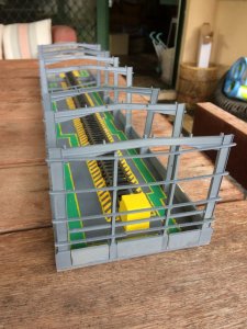

Managed to get some time to progress this shed a bit further. Not too happy about the portal frames, they are to scale in width and depth, but I have made the flanges and web oversized to give it a bit of strength. Not sure if I should make the portal frames oversized.
Not to work out the flooring, should I print the webforge or 3D print it?
Cheers
