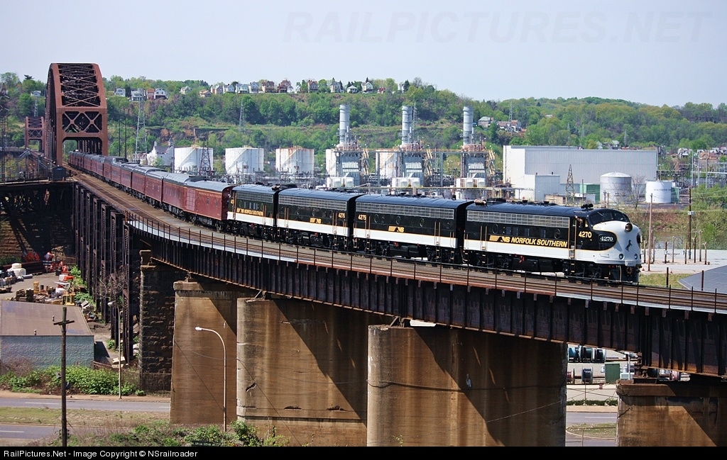

What is the correct scale distance between an F7A/B unit?
I have an Athearn set, the A is a modern unit with body mounted boxes, the B unit is the BB design with frame mounted couplers using those silly plastic clips, using the included hook and horns, it just doesn't look right, too much of a gap, but I've never seen a porto to judge it by.
Also, does anyone know of a source for the bellows, if I'm using the right term.
Well here's a photo of one. I would say the proto is about 3 ft. So the HO size 1:87. So a scale of about .41 inches. Just less than a half an inch.
Thanks for the info, I'd never seen one either, now to find the right couplers to close the gap up a bit.
