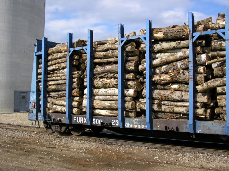

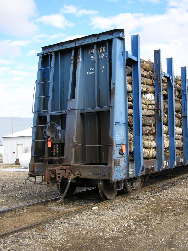

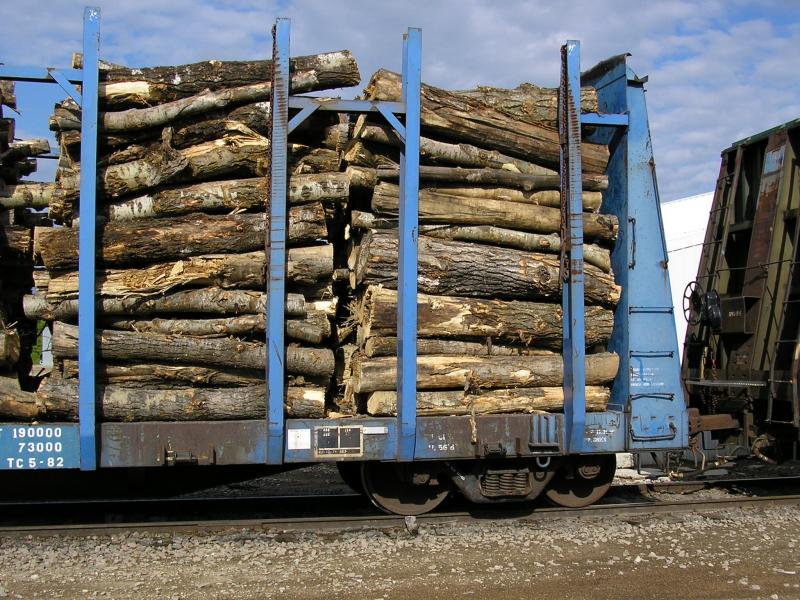

Here are some prototype photos that might be helpful for weathering your blue cars:
One trick I like to use to model a metal surface that's been rubbed raw -- like where the logs contacted the bulkheads, floor or stakes most recently and hasn't had a chance to rust over yet -- is to go over the surface with a no. 2 pencil. The graphite works out to be a good metal color and has a certain sheen that makes the part appear metallic without being shiny like it would be if you used silver paint. The insides of the stakes on this model have been rubbed with a pencil to get that effect.

Thank you for the pictures. I have views of the blue ends from a distance and usually with a car in between. These are so helpful and very much appreciated. I like the graphite idea using a pencil. I am looking for prototype pictures of the pulp car floor. I have seen in person cars with plate steel but nothing in person with wood. Those in person pictures were on an external hard drive that went missing on the move from Central Wisconsin to South Central Wisconsin in 2014.

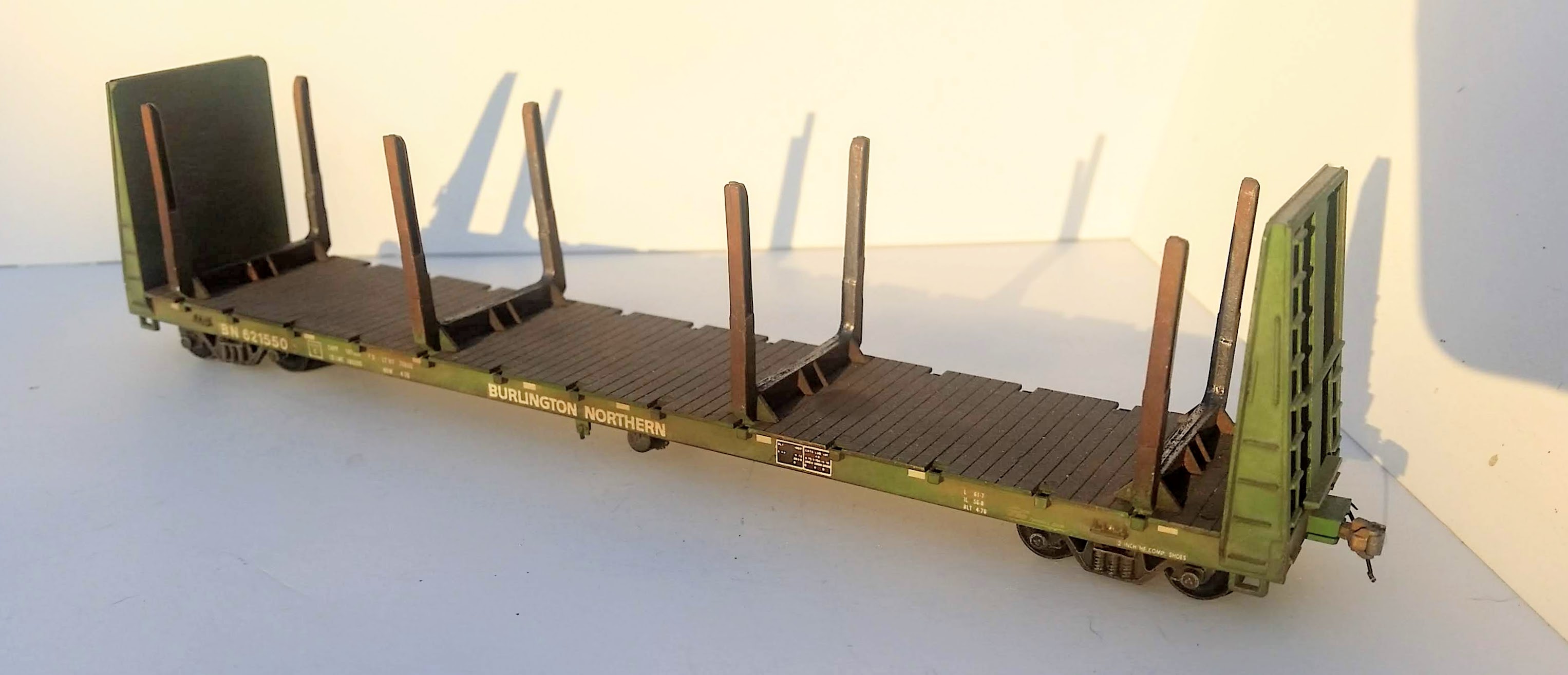

Cars specifically built for pulpwood/log service generally won't have wood floors. Some older flatcars that are converted to log cars might have originally had wood floors though,
but also sometimes have the floor boards damaged and/or removed.
