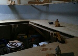

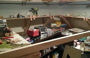

Recycling Beechwork
Last March, I made the decision to pull apart my 6th layout, and begin my 7th. Money was a rarity, so I decided to get the most out of the benchwork I already had. Layouts 5 and 6 had both been built as shelf layouts utilising brackets mounted to the walls and plywood bases on the brackets. Layouts 5 and 6 both made good use of the ply tops, but the accumulation of plaster, cork and other products meant it was time for a new surface for layout 7.
Cleaning off the original surface proved painful and time consuming, and failed to allow for subterranean features. Insulation board was way too expensive, as were foam risers. I ended up clearing anything tall and easy to 'snap' off the surface,and this gave gave me an idea.
You can see in the foreground a large length of timber. This is one of many spacers which I attached to the original layout surface in places where the surface could be cleaned and smoothed. I then purchased new sheets of plywood which were attached to the top of the timber spacers. The original layout surface now provides allowance for subterranean features with a new clean surface above it. The old layout is essentially buried beneath the new one, hidden by a neat fascia completing the look.
This photo shows the new surfaces about 1.5in above the old surface. The added height also changes the viewing perspectives of the layout.
So instead of new benchwork and costly foam board or similar materials, a 9x8ft or so clean slate came in at less than AU$100 for new plywood, timber spacers, and other materials such as liquid nails, etc. New benchwork would have been nearly triple that cost.
Not bad.
