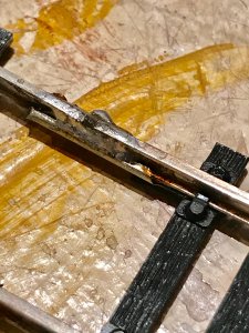

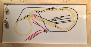

Hi all, I posted this on another site also hoping to get some ideas. I have 6 DCC locomotives. 3 Steam and 3 Diesel. Only 1 stops at this same spot on a very slight mainline curve.
Right about where the mark is. That curve is really about a 38* radius. There is a gap just prior to that spot but both sides have feeders.
The two 282's, two SW1500's and the SD7 blow right through. The 462 Pacific stops then sometimes will start up again on it's own after about 3 seconds.
Any ideas?
As it's near or at an insulated gap, I would say you could have a peak (high spot) at the joint. I identified one just like that on the club's layout last weekend, that does the same thing. Doesn't take much to lose contact on some locos.

while the tops of the track may be clean, don't wheels really make contact with just the inside corner? is it clean?

Thanks for all the posts. The loco is a BLI Paragon 2 0-6-0. I'm in the process of replacing the track in that area so that there will no longer be a gap. It was left over from when the layout was DC. The Loco itself checks out, wheels on loco and tender all in gauge and clean. All my other BLI locos ran right through.
I would have to agree with you Ken. A bit more head and a bit less solder.
