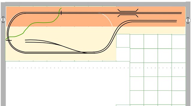

OK, here's another really rough plan, this time on the other wall - so 14'. I've put a station terminus on a shelf (orange) and then it drops down onto the 4x8 before heading out to a rural station on another shelf underneath the other (yellow).
Then I perhaps have a bit of room to add either an industry or a yard - nothing fancy (a turntable and roundhouse would look nice but that's an expensive option) probably just a engine shed or two.
My only concern at the moment is the "short" nature of the journey.

Looks good to me.
But is it drawn to scale? What are the radius on the curves? They look a little tight.
Also, you have a reversing loop. So you will need a DCC autoreversing unit. Take a look at Tony's Trains PSX-AR. I have one, and it works great.
Are you still going to run 85' passenger cars?
^Well its sort of to scale, the squares at the bottom of the image represent a foot each, but this plan is a bit of a guide to get a plan before I start going into specifics. I've already thought of a few tweaks Including another separate loop that stays on one level - then I realised that I still only have 4' to 5' to work with! So its all still up in the air at the moment.
As for the reversing loop - thanks for the tip - I'll have to bear that in mind. Worst case scenario, I can always have it just as a one way line - it could even end up as a siding in the station or part of the brewery.
As for the 85'ers well, I've gone this far being resigned to never being able to run them so I guess if it doesn't come off this time around I won't be too disappointed. I've only got one coach so its not a huge loss.

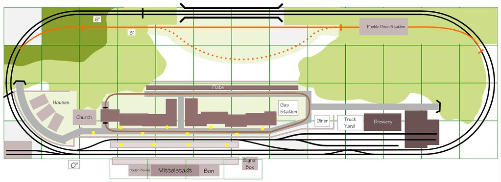

Right then, I've been doing a bit of specific planning and have come up with this:
Its not 100% accurate, but its a bit better than my previous efforts.
Keeping it 14x4 and while it maybe a bit constrained depth wise I'm trying to get as much as I can out of it.
I think I might add the gradient towards the back (nothing too high (gradients shown are not specific)) and the possibility of the inner track taking a lower 'pass' rather than going up with the outer line.
Then I toyed with the idea that the inner loop can curve inwards (orange dotted line) or just keep straight (solid orange). The curve on both is a little tight on this drawing, but in reality it can go a bit further back before curving "in".
I'm starting to think that this might just work!
Hi Mark -
A couple of things.
I'm still concerned about how you will reach the back of the layout, both for constructing it and operating it. If the squares on your drawing are 12 inches, then the back edge of the layout is 48 inches away. You won't be able to reach it without either crawling up onto the layout or obtaining some sort of cantilevered scaffold that extends over the layout. Most human beings of normal stature can reach about 30 inches maximum.
I see only one crossover from the inner to the outer loop. This means a train traveling anti-clockwise on the outer loop can not enter the inner loop except by backing into it. That will be unwieldy at best.
Do my eyes deceive me? Or do I see a grade rising from zero in the front left corner to 2 FEET in the back left? That is a rise of 24 inches in a run of about 60 inches, or a 40% grade. That won't work. Maybe you meant it to be 2 inches rather that 2 feet. At 2 inches of rise in 60 inches of run, your grade is 3%. That's still more than you would normally want on your main line, but it is at least workable if your trains are fairly short.
- Jeff
^In terms of the reach issue, during the construction phase I'll have it away from the wall so I can get to the back. Once its all complete (whenever that might be! lol) I'll still be able to move it forward is anything major is needed.
For the crossover, well the station part of the plan is based on my original layout from 20 years ago. However, come to think of it, it did have a second crossover by an engine shed to the back of the table.
I think I can easily add another switch somewhere by the brewery. Although to be honest I'd not thought of doing much manoeuvring as the outer would be predominantly passenger and the inner is for freight.
As for the grade, its not accurate. Its purely aesthetic at this point. In reality the outer will only go a fraction of that. Just enough to get a bridge with a decent looking drop.
My previous attempts at a figure-8 layout taught me that you need a shed load of space to allow things to run smoothly up hill..... with out the engine labouring and the boxcars breaking free and heading back down the hill. ;)
Plus I do aim to run a Class 395 Javelin from time to time, and while she's fine on the flat I'm not sure how it'll handle a gradient. So I've got to keep it smooth as I can.

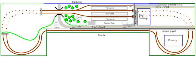

OK, another revision. This time the station moves to a shelf on its own, I've then raised the town scene by a couple of inches. So the line at "platform 3" is next to a retaining wall.
I've also added (although I'm not sure it could fit) an engine shed.
