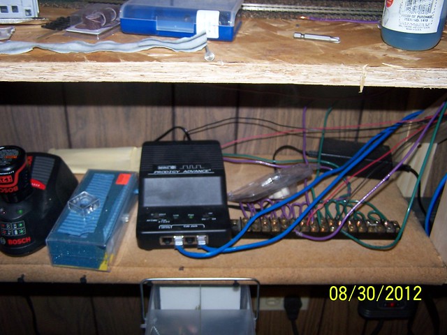

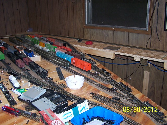

well here are some shots of the progress!!!
