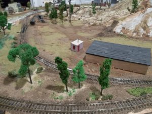

Some photos of more scenery work "completed", first the machine shed with gravel extraction area in the background:
( I like to have some areas that are kind of open landscape to run the trains through.)

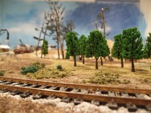

Here is a small orchard, the track was painted with the woodland scenics rust marker:

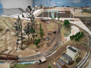

And here is an overview of the area:
Thanks for viewing!! lasm
That is some really good looking landscape work. Keep the photos coming.

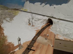

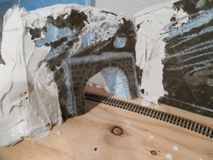

A couple more photos, saw this trick on utube, using a pencil to trace out the rocks out of the foam and bingo a tunnel portal!! I will be going with several layers of mud to try to get the nice rock face that a lot of you guys are getting:
The spray foam insulation that comes in a can works good to bind the screen to the foam and also to reinforce the foam to the plywood.
The plaster on the right and left is just covering the spray foam insulation.

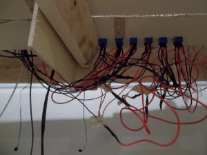

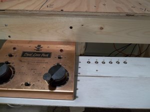

Here is my transformer and DPDT switches. I didn't know they would be so small, got them from ebay, 10 for $15.
The wiring looks terrible from here, I used jb weld to make a hard plastic cover over all the connections, to assure they don't come apart by mistake.
