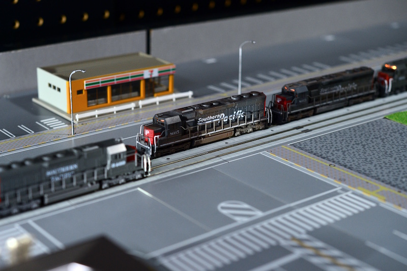

I like that second photo in your 19rh post with the buildings behind the train, very cool!
I'm regretting selling off my unitary now, I was going to do a coffee table layout at one time.

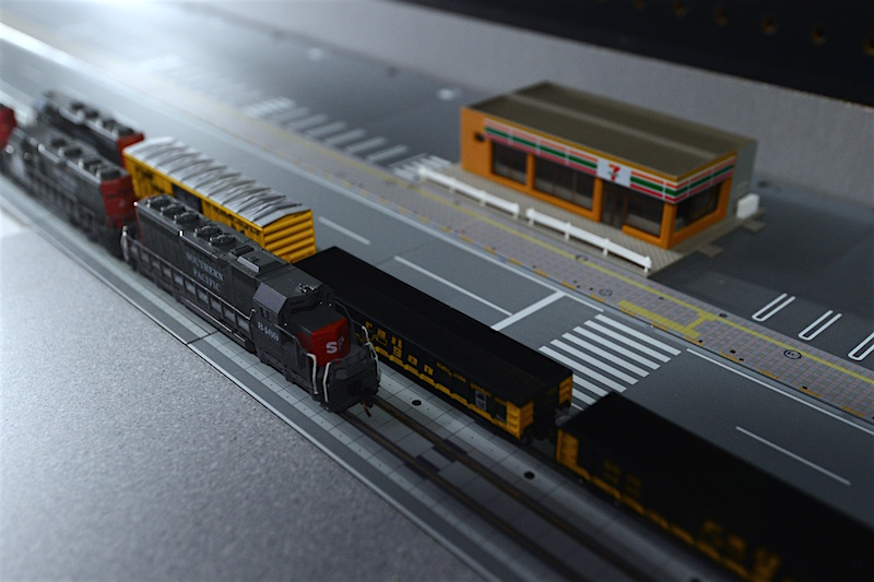

Thanks! I'm redesigning everything! I just got my three V52 Unitram kits 20 minutes ago from UPS! So, I'm reconfiguring the entire rear layout right now. The V53 kit is out for now. The buildings will be relocated to the middle of the layout to reproduce that train-by-the-building effect. The V52 kits are perfect--I'm able to actually run the road to the end of the layout. I won't have roads that just friggin' end in the middle of the layout.

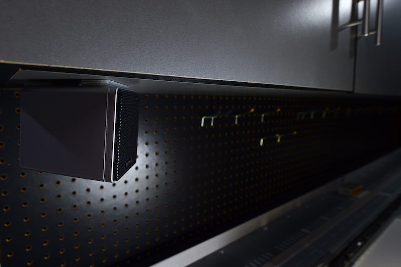

I just plugged in my new Kato Soundbox (above) with the included first-generation diesel Soundtraxx sound card installed (which has recorded sounds from EMD 567-series' motive-power). I'm not using the built-in speaker, instead, I've connected an old Sony surround-sound stereo system to the line-out output of the Soundbox (L, R, center-channel, and a sub-woofer, using a synthesized surround-matrix). My first reaction, once powered with the Sony amp and mini-surround speakers was, "Wow!"
The high-fidelity, authentic-sounding Soundtraxx recordings can't be fully heard or appreciated on the built-in speaker, but even a low-end stereo makes this system sound incredibly realistic. Add a moderately priced (e.g., ~$100) powered sub-woofer to your system for some really impressive low-frequency rumble! Even at idle, there's enough randomly generated sound to keep it interesting. The "start" and "sync" potentiometers are a bit difficult to figure out, but once configured properly, the box adds momentum features to the Kato controller.

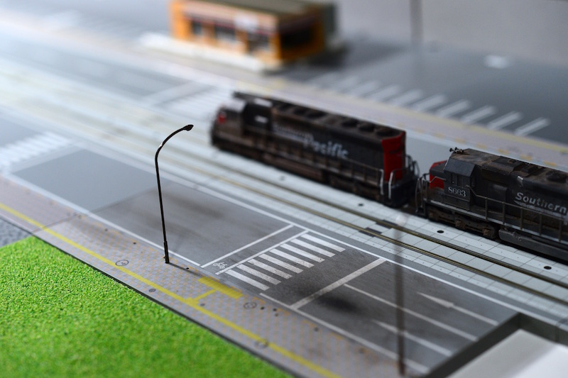

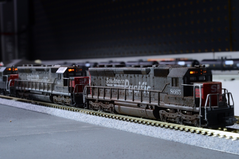

My first weathered locos ride the rails! Shown above are two of my brand new Kato SD45s, with brush-applied PanPastels powders. I also painted the handrails white and added a couple of oil streaks on the fuel tank using some acrylic model paint.

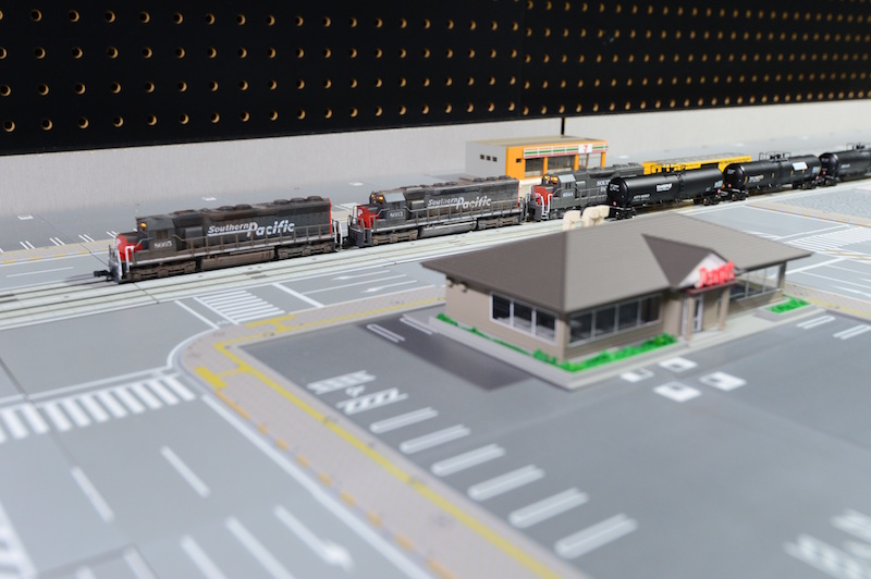

Anywho, because I was too lazy (and too impatient) to model my own roadways, I went with Kato's V52 Unitram roadway kits (hence the title of this thread). I thought, perhaps with a little weathering, additional scenery, signage, etc., they might look "okay." While the PanPastels powders are quite good (used above), the powder doesn't quite scale-down finely enough to always blend-in unnoticed into N-scale sized layouts.

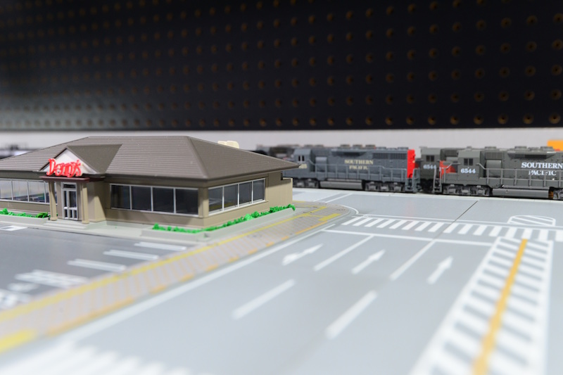

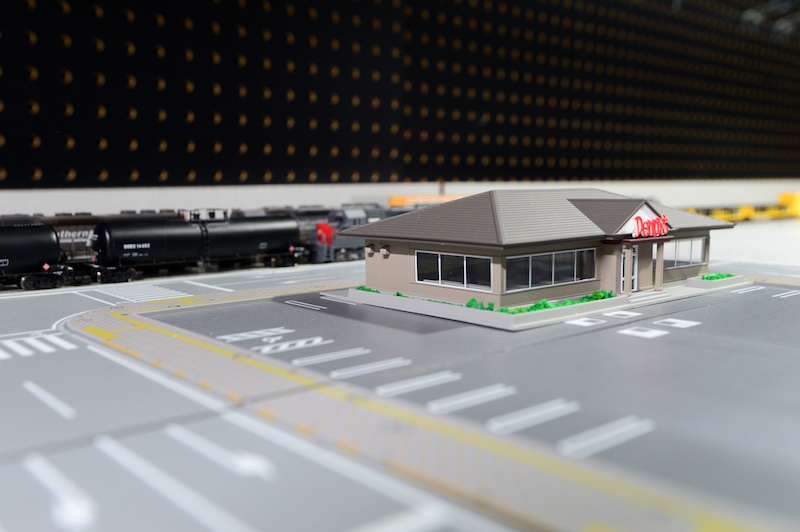

I was able to recycle the V53 kit into a parking island for the Kato Denny's restaurant above. Adding the V53 kit re-introduces the "roads-to-nowhere" issue, but less so in this configuration. At least the modular design of the Kato kits allows me to experiment with different layouts before committing to a permanent design.

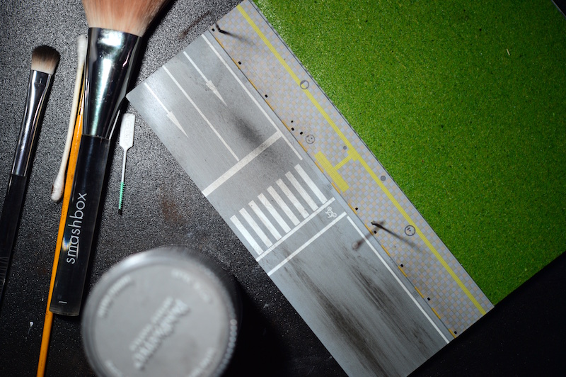

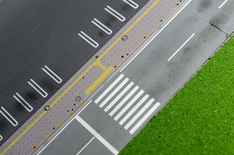

Found a can of removable 3M Dulling Spray in the garage, and applied it to a Unitram street above (but, I didn't let it dry fully before applying weathering powder, hence the streaks). I've been putting off an airbrush purchase until my credit card settles down, but I think that may be the better application for weathering plastic streets. I think dull-coating, oil marks, and adding the Kato streetlights may eventually make the Unitram streets appear "passable."
The black weathering powder didn't dry neutral-gray (possibly due to the dulling spray), and turned the gray Unitram street slightly magenta, as seen above. So I removed the powder and dulling spray residue with some Windex. Instead, I dusted my Unitram "test-street" section (not shown) with white and light-gray weathering powders to take the sheen off.
