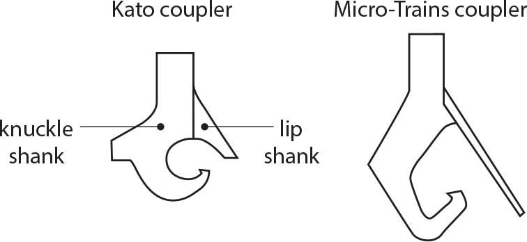

Thanks for the Kato recommendations. I confess, I had been disregarding Kato. I have some freight cars from them that are "just okay", apart from the couplers which are a bit dodgy and prone to spontaneously uncoupling, and I had assumed that their locos would be the same.
