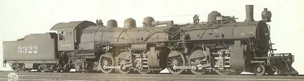

A Prarie mallet perhaps..... :)
(Photo courtesy Dampflokomotiven - Gunters Eisenbahn Seiten)
I know that it has been made in brass.
It needs to be a N&W prototype, or at least close, and brass is financially out of the question. :)
