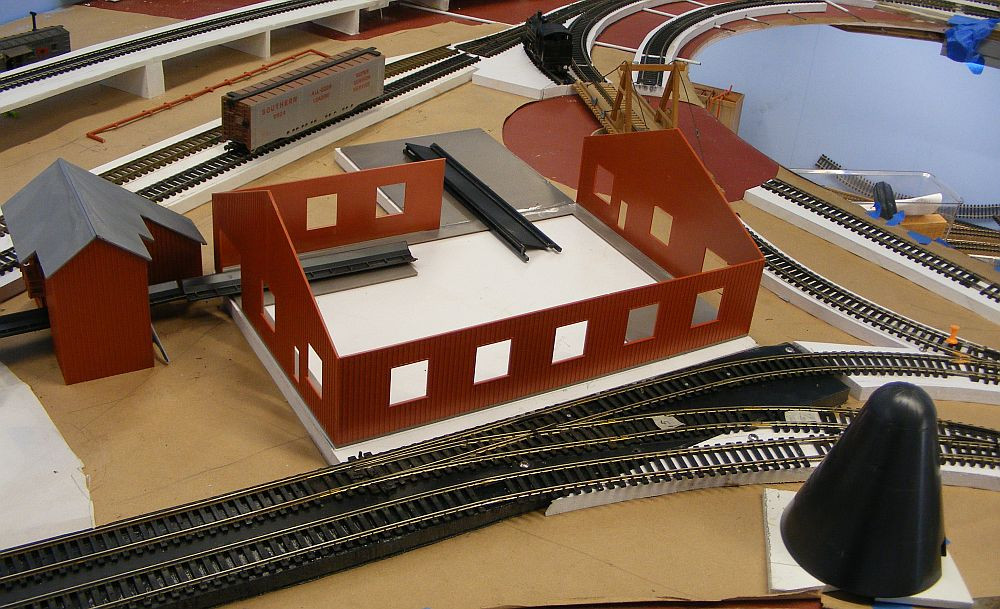

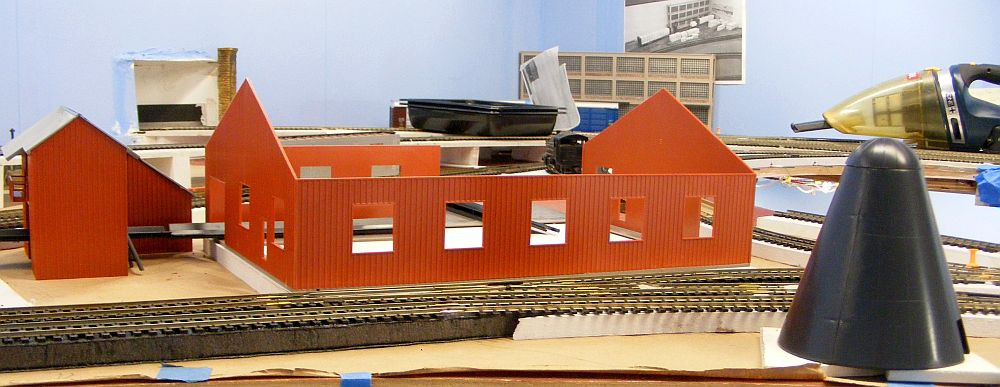

I decided to get that kit out to check some of my clearance more closely. I had forgotten that my rendition would be a little different than the stock kit. I wanted my covered shed/loading dock located on the other side of the main shed,..
like this..
rather than like the stock kit,..

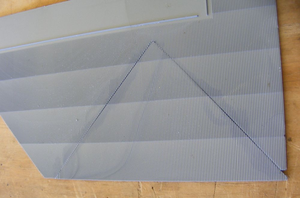

One particular item that has me concerned is the relief in the roof that provides for the adjoining roof for the shed area.
Could I possible cut the roof in half and reverse the ends??
Has anyone seen modifications to the Walther's lumber mill building??
I may have to create a new roof, but before I do that I would likely experiment with that original supplied one.
I was looking thru 'images' to see if I saw any that folks might have modified from their original form. Has anyone seen something like this?
I think I am going to try and cut out that triangular section, and a corresponding section in ribbed portion, then exchange those sections.
Hopefully with a good fine, sharp saw I can get a nice clean cut.

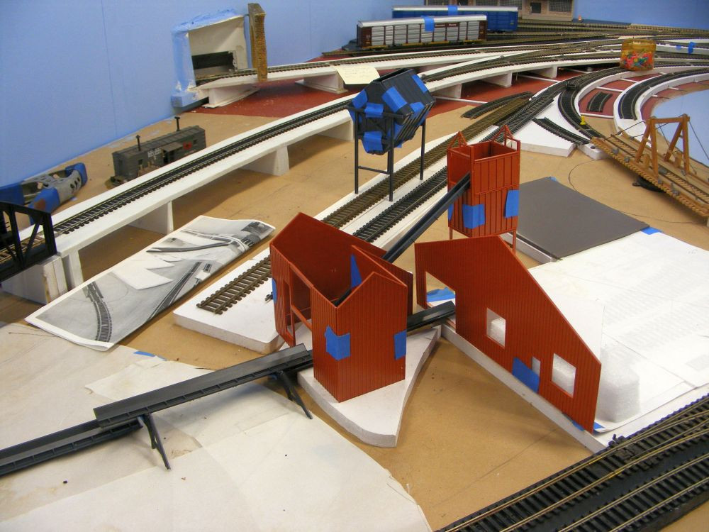

I was having some fun yesterday.
I was trying to make sure I had enough room for my debarker when I moved the saw mill closer to the pond, then played with several locations for the wood chipper that I had not even planned on, etc,etc. Nothing set in stone yet.
I got my turntable to fit in there without shorten it.
Then I decided to go ahead and start assembly of the saw mill and a few of its out buildings,...just get a 3D idea of my selected overall plan.
One item that stood out to me right away was the windows that were supplied with the original kit. did sawmills really have lots of formal glass windows,...I don't think so. So I did NOT install those. Rather I am going to look for other images that might be more representative,...perhaps no window framing at all.

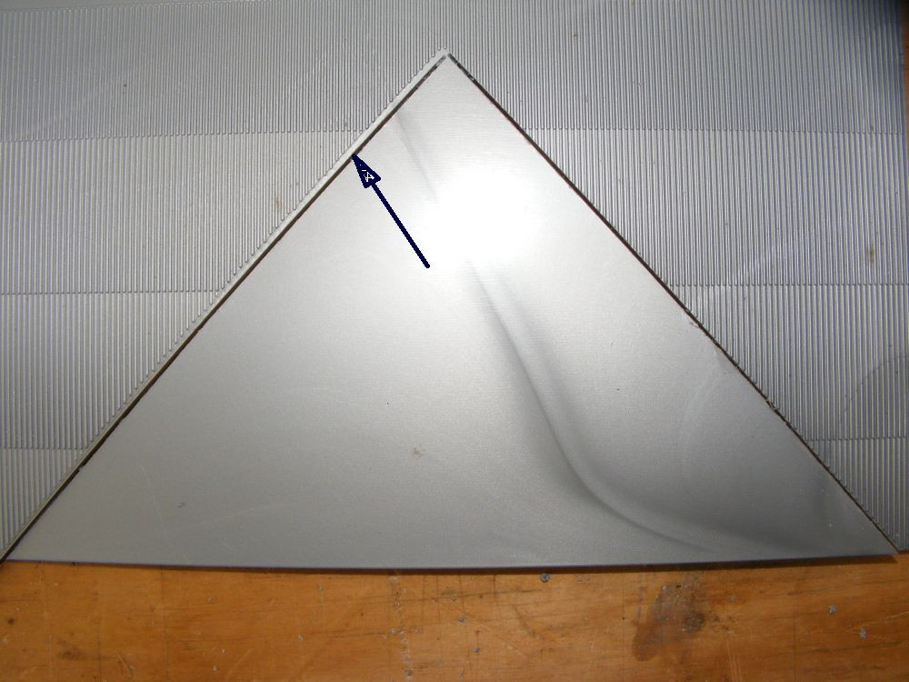

Sorry for being so anal about this job of cutting my roof, but like what was pointed out, I could end up cracking the plastic rather than getting a good clean straight cut.
I got one of my good saws out, the widest one I had. I also clamped a steel ruler in place to use as a guide. My very first cut was misaligned just a very slight bit as shown by this arrow . That was my fault, or my crooked eyes'...ha...ha . That's all right I can file that extra little bit out.
Here are the tools I used,..
And here is the new piece I cut out of the other end and inserted it in the first spot I cut. ..Not to bad of a job if i say so myself
I have decided that I do not need to put the untextured blank back in the spot were I got the piece of roof. The thickness of the plastic makes it stiff enough, particularly with the kit's inner roof beam. Besides real roofs didn't have that portion in them.

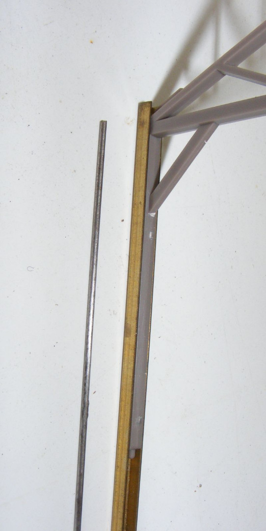

At first I thought about glued a piece of music wire to one side of the plastic upright,...after all is very stiff strong wire for its size.
Then I decided to look in my misc box for something like a 'L' beam piece of metal. SURPRISE, ...look what I found a channel shaped metal piece that almost exactly fits over the plastic post. I like this idea!!
