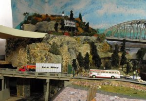

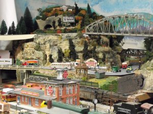

My N Scale town of Summit on my HO Scale Fox Valley layout. Church steeple on top I think it works. The red building is actually a container for holding postage stamps!
View attachment 42271View attachment 42272.View attachment 42274
Good effect Gary. The multi level elevations and the billboard and trees on the top level make it work. Curious as to what the front to back distance is from the REA building to the N scale buildings. More room than I have that's for sure. ;)

Thanks. From the REA building to the church steeple is only about 3 feet. Remember, this going diagonally across the layout so its not covering as much space as you may think it would.

Great for a photo but I don't know what it would look like in real life. I actually think Gary B's church might be the best example I've ever seen. I've even got a couple of those little churches sitting around (Bachmann as I recall). Might have to use them on the HO now.
Iron Horse - Thank you sir! I've always liked the way that turned out. I don't recall the origin of the church but I sure it's a cheapy.
I think it looks great! Seems to me you have a lot of factors working to make that so: as others have pointed out here, you have some depth to work with...how far is it from the observation point to that peak? Maybe 3' or more? The track running across to the bridge also creates a visual "break" that makes the illusion work. Then foliage, billboard & rock wall create another break. Finally, the foliage obscuring all but the upper parts of the structures adds a final visual 'trick'... Nicely done.
I'm among those who just don't really have enough depth for forced perspective to look right...
Thanks kjc, actually the first picture is about only five feet deep. What actually makes it all work is the fact its in a corner. It would work just as well on a 4X8 if placed in the corner. In fact, come to think of it, the layout was pretty much a 4X8 when I first created the little town up there. The trick is there is only one view point you can't get too close.
