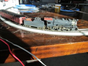

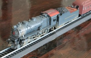

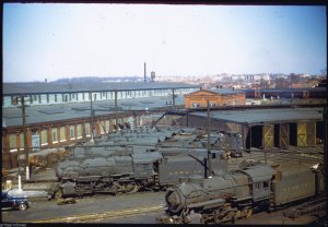

extra cab window
OK, now this has got me stumped. In all the other photographs of G-5 locomotives I have seen I have never before seen a second side-window in the cab, as appears to be what we are looking at on the two nearest locomotives. Anybody got a clue about this modification?
I also find it curious that all the locos are nearly the same color pale gray. I'm guessing that when the LIRR went to gray passenger cars they painted the locos the same gray color. Notice the side rods are painted. Anybody know anything about painting the LIRR G-5s like this?

Your question has prompted me to do some research on the G-5. It appears as though the appropriate engine numbers were 30 through 50.
Looking through numerous related websites, engine number 117 in the background was manufactured in 1902 and given the model number G52-simple, manufactured by Burnham Williams and Company.
I was only searching the Long Island road name and ignored the PRR stuff.
Maybe they called these G-5's, too. Anyway, if anyone finds other resources on this, please chime in.
