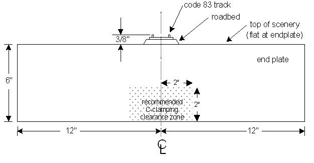

Now, regarding the Free-Mo build and its standards, I've made progress with the track plan and layout design.
While I have most of the materials needed for the construction, a few items ordered from England are yet to arrive, which are currently the only delay in this build.​
These are the free-mo standards http://www.free-mo.org/standard/
