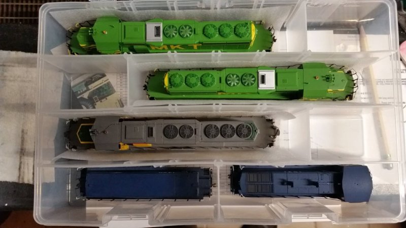

I purchased some storage trays from Michaels, a few years ago. They are stackable, the lids are hinged and snap locked. I happened to catch them on sale and got a dozen of them for 70% off. I made dividers using foam core board and fold paper towels to act as buffers, while transporting. I divided each box into 7 slots, which eliminates side to side shifting.
Lid Closed
Lid Open
