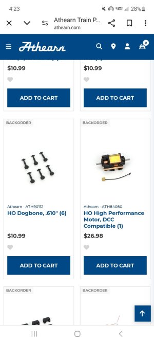

What a painful process this is going to be. I'm motor swapping this athearn with a motor with flywheels but the diecast is too high, so I'm going to have to cut it down.
What a painful process this is going to be. I'm motor swapping this athearn with a motor with flywheels but the diecast is too high, so I'm going to have to cut it down.View attachment 191487
