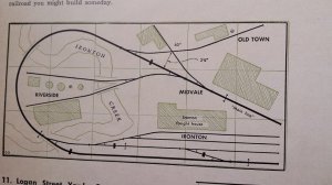

I'm going to build on a 3x6 plywood base. I was going to use cork, but since it's an industrial switching plan I'm going to lay my track directly to the ply. I'm still thinking, but I'm liking the idea of it looking like a shoestring operation, so ballasting and other things will have the appropriate appearance.
