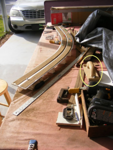

I have to revise this statement. I will NEVER sand down cork in my train room again,..if at all possible. It produces a very fine grain mess that readily spreads throughout the room, and even becomes somewhat electrostatic sticking to vertical wall surfaces. The granular mess even 'penetrated' thru my Ryobi hand held vac to redistribute itself on adjacent areas.
Look at this mess when I took the sanding outdoors to my work bench in the car port

I ended up sanding the cork roadbed on a number of my grades. Several I did inside the train room, and several I did on the outdoors bench. I would STRONGLY recommend NOT doing this sanding indoors,...too much fine dust.

I tried several power sanding methods, and was less satisfied with this 'control' verses the hand sanding blocks. Surprisingly I found the had 'sanding board' with 50-80 grit paper was more effective than those rasp.
