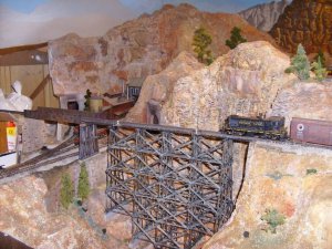

We all seem to develop our own methods of doing things. I wonder why you used the foam ribs (cost) covered with screen (cost again) instead of cardboard strips (free) covered with either paper towels dipped in plaster; or, the plaster impregnated gauze material to cover the base? Your way seems far more complicated to me. However, I don't begrudge you your method, as I'm sure like my method, we become comfortable doing it the way we do. In my photo below (the scene is still not quite complete) this area is covered with a cardboard strip lattes and covered in Woodland Scenics Plaster Cloth; or, it could have been plaster dipped paper towels. It is then covered with a layer of Sculpt-a-Mold, that is carved into shape (the term "carved" is sort of a misnomer and the reality is it is "worked" into shape). Please don't take this wrong, I am interested in all manner of doing scenery and will follow along with any videos you provide in the future and thanks for sharing!

D&J, I used cardboard strips through-out the entirety of my layout as the forms for the scenery base. Naturally these cardboard strips got wet in the process of laying on the plaster soaked towels; or, plaster impregnated gauze. For about a week, both the plaster and the cardboard strips had fairly high in moisture content. Then everything dried out and is bone dry now. I don't see any bugs; or, other problems with this method. In fact this method has been in use since back around John Allen times and I have never seen bugs mentioned by people who used cardboard or wadded up news papers as a base for their scenery. I should think that if this where an issue, we would have heard people say something!
