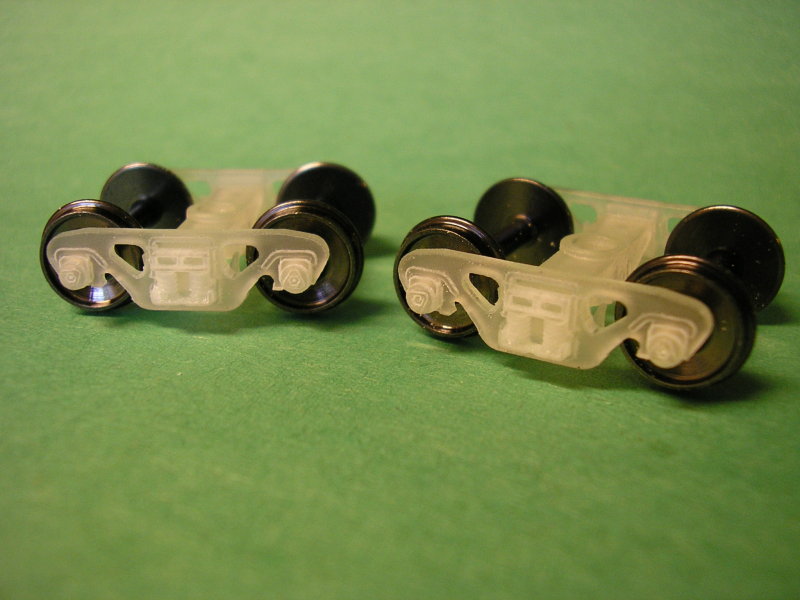

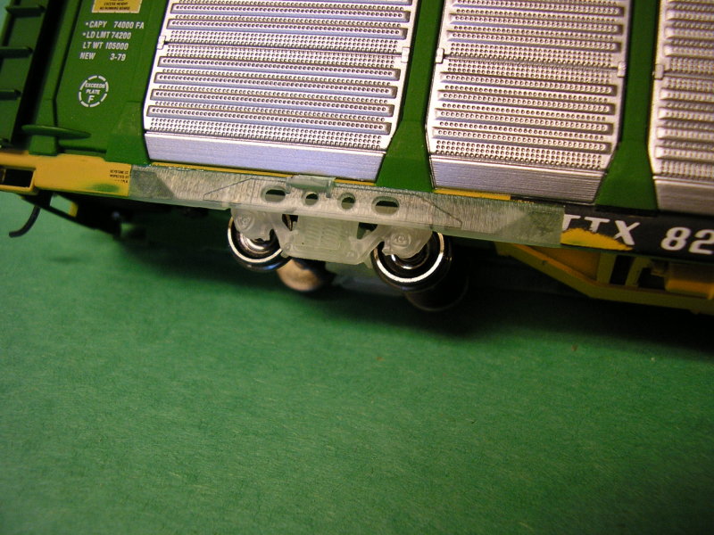

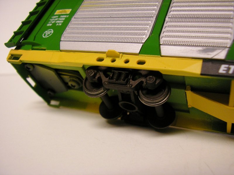

I wanted some of these trucks so I 3D printed them. Here's the 28" wheel version of National's swing motion trucks:
Six spring pack 33" wheel version (Bowser also makes this truck, but this example is 3D printed):
And the 3D printed eight spring pack version:
