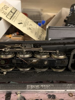

(I do want to add that the Rivarossi versions of both the Big Boy and Challenger had no electrical pickups and were very light. I have added weight along with the decoder, speakers, electrical wipers and keep alive as room was not available in the boiler without removing a huge amount of much needed weight.)
I have bunch of rivarossi big boys how did you install copper wipers for electrical pickup if you dont mind me asking , i need to replicate it
thanks
thanks
Just saw this. Sorry reply is so slow. The centipede tender is relatively easy by using glow on wipers. Locomotive has soldered wipers

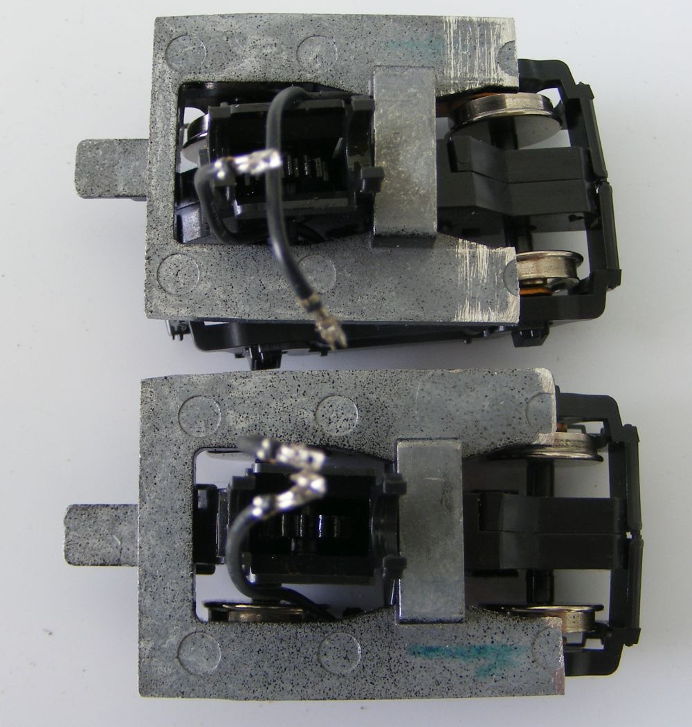

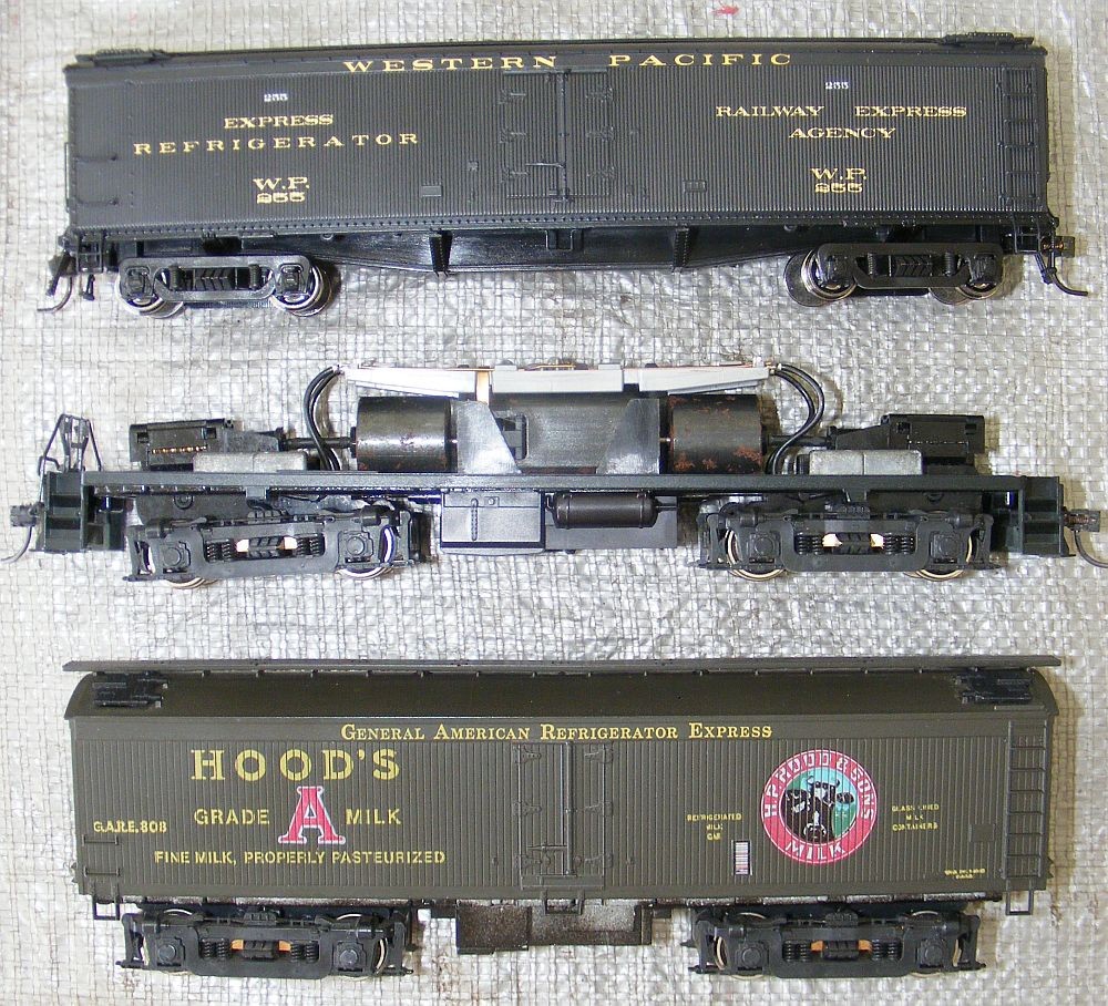

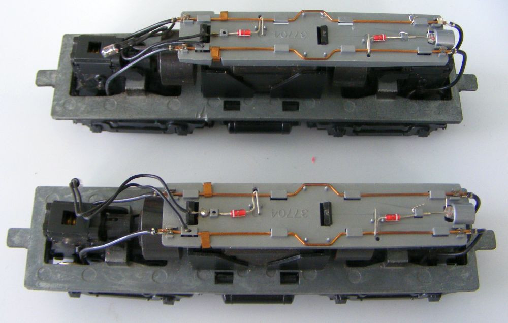

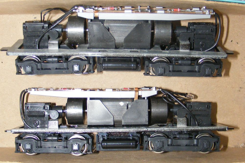

After running those very successful pushing test with the PRR C-liner and the C&O Stewards, I decided to go back and look thru my big box of items I had set aside to possibly use in this search for a helper/pusher,....both shells and power chassis.
I immediately discovered some power units I had forgotten about (ahhh, memory ). I posted a few pics over here, ..
https://forum.mrhmag.com/post/power...diesel-powered-trucks-12225270?pid=1340375535
These trucks are MUCH better representives of those that would be found on express freight or refrigerated cars.
Both of these trucks are on power chassis that are Kato built,...and most of us are appreciated of that brand.
Now i need to figure out how they can be stretched or shortened, and made much heavier. I really like their looks, so that effort will be will worth it.

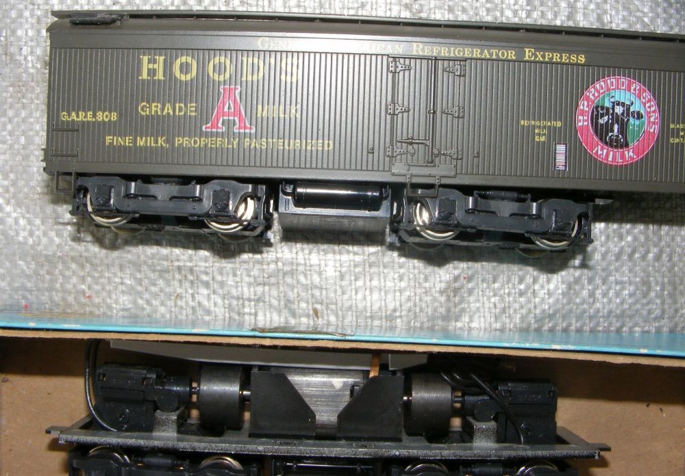

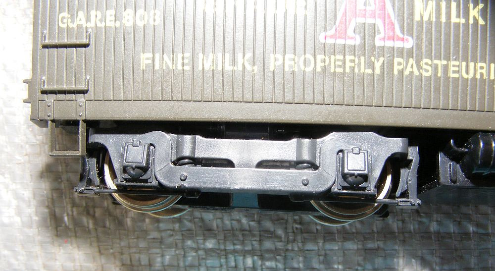

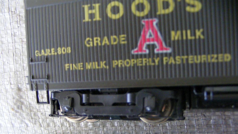

OK,..... I've started building my first pusher/helper.
I have chosen the shorter of these 2 chassis to begin with. They both have the same Kato motor power, but the trucks on this chassis are sightly shorter/smaller,..more akin to what the reefer might have.

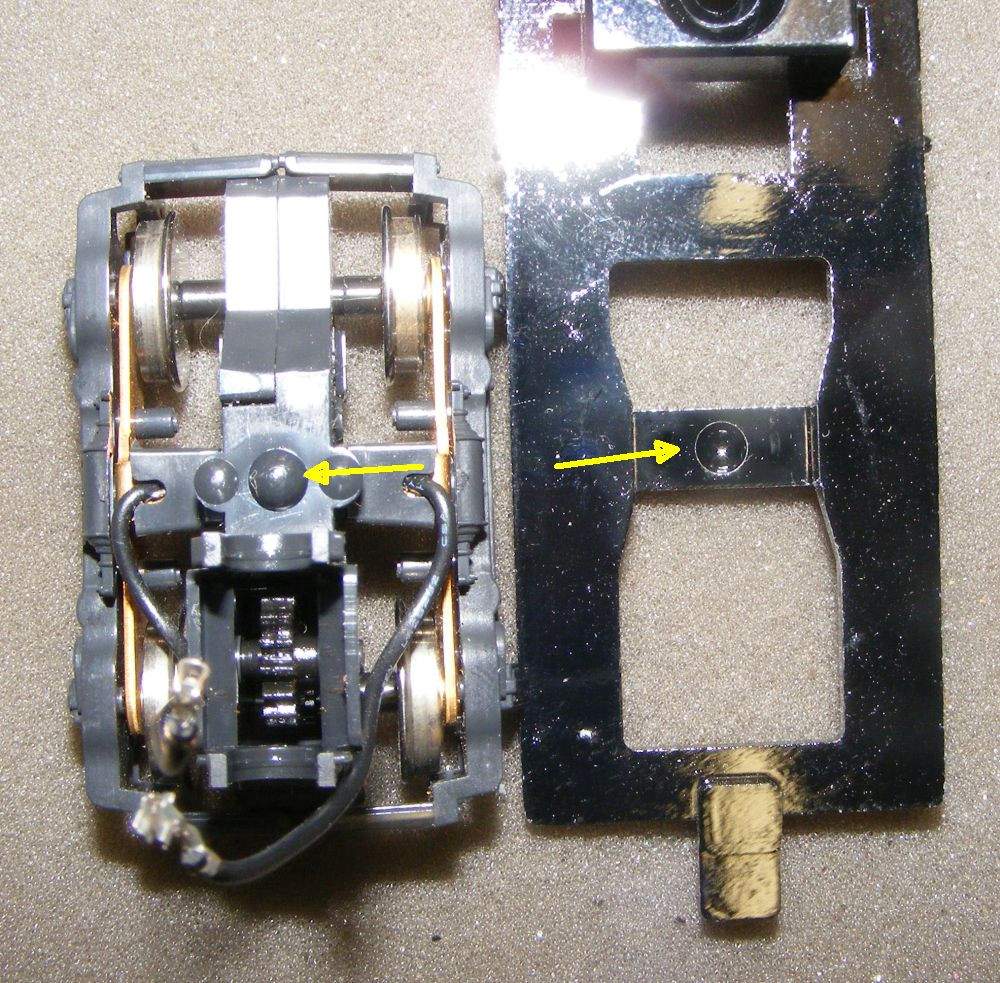

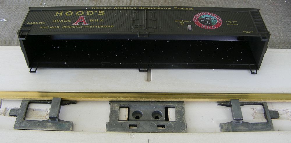

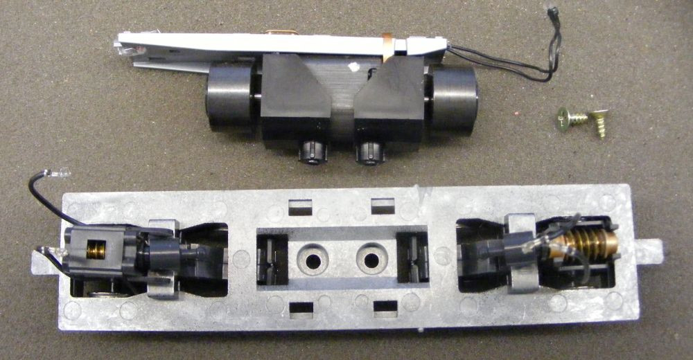

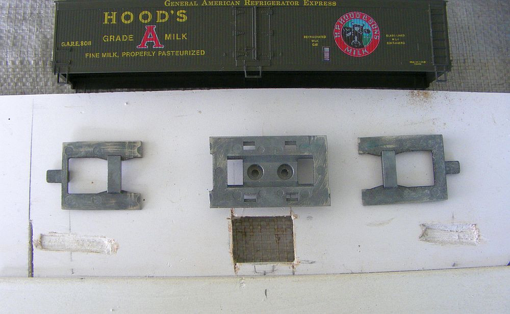

I'm going to be cutting this chassis into 2 'lengths', or maybe 3 ?
I decided on 3, so I could keep the motor in the center of the finished chassis. So now I need to decide on what reinforcement I could fabricate to hold all of these 3 pieces together. These brass strips looked ideal. They could be screwed or glued to the chassis bottom plates, then weights added along their tops. I had one such strip, but it was too short to do both sides,...plus I thought it might be nice to have a bit thicker strip. I found those K&S strips in 36" lengths on Amazon, and got 4 of them mailed in yesterday. That will give me enough material to make more of these pushers.
Loosened up the motor screws to see how it might interfere with my long chassis strips, and get ready to segment my chassis,..

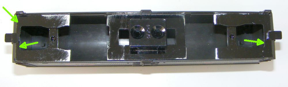

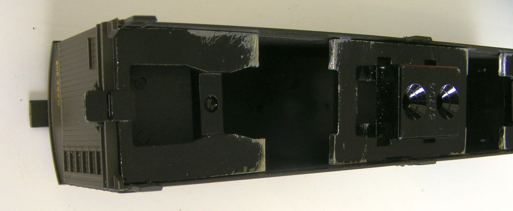

I took a fine to clean up the edges of that chassis, the test fit it into my reefer shell,...what a GREAT fit,...like it was made for it. I'm getting excited about this project.

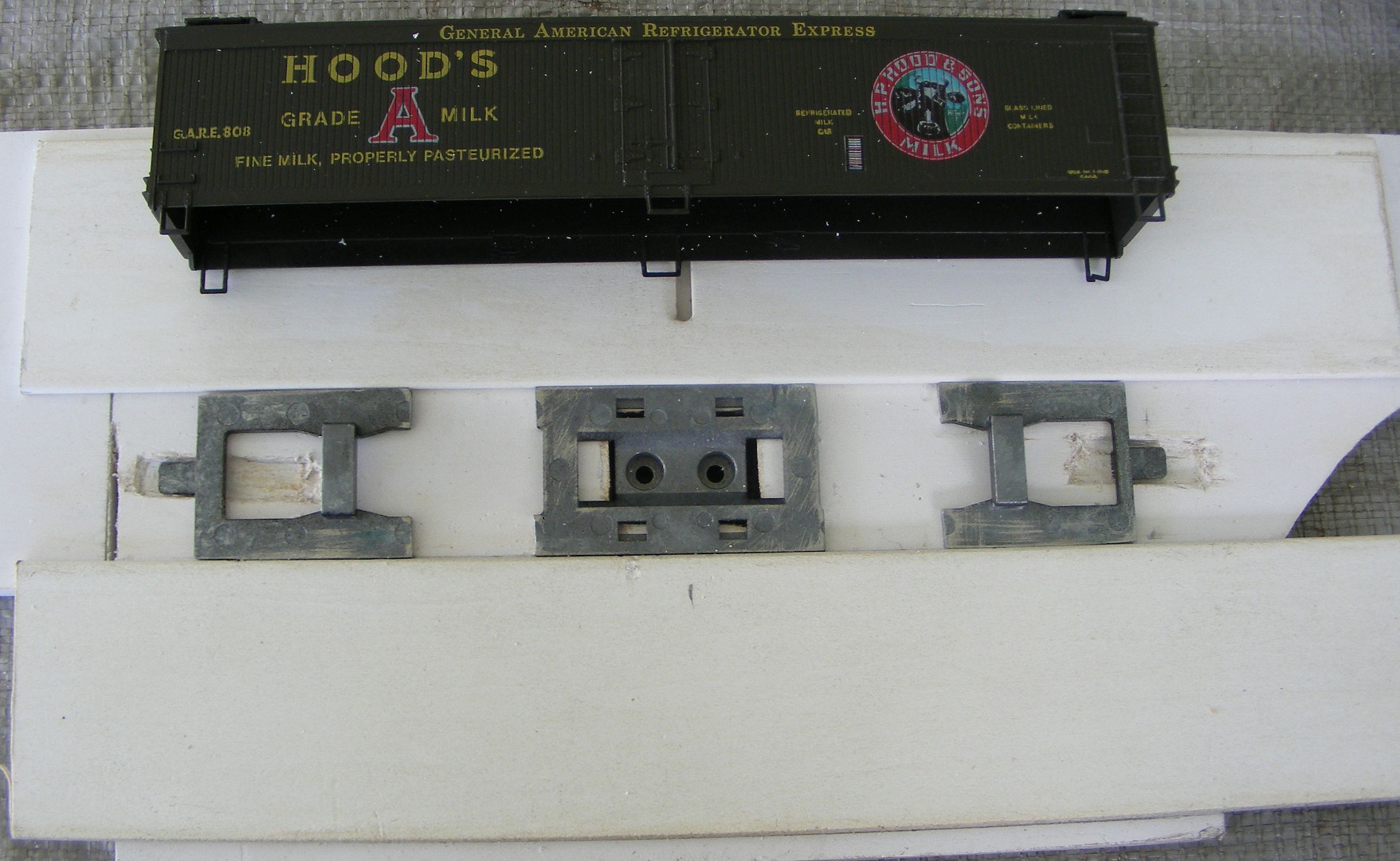

Lets cut the chassis up into 3 pieces,..

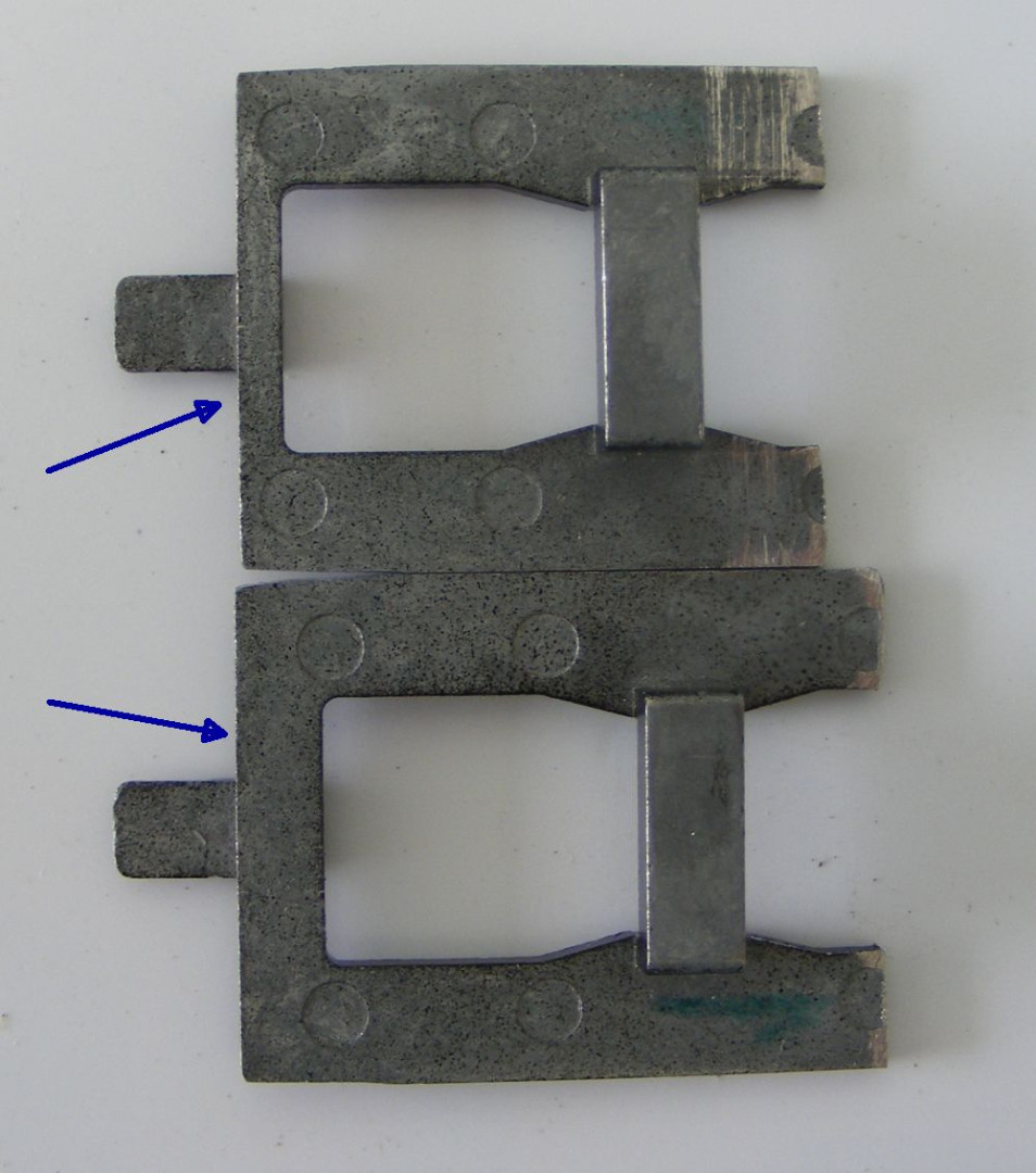

I discovered this small discrepancy in the two ends. I'll address this later.
Look at this preliminary fit,...fantastic
In order to make the 2 trucks equal distance from the ends of the car, there is going to have to adjustments made to the fitting of those 2 end pieces of the chassis,....
I need those 3 chassis pieces lying dead flat, ....and in perfect alignment when I am attaching the brass strips. I figured the best way to assure that,.. was to built some sort of assembly jig. I decided to build that of my PVC 'plates' that I could provide the relief holes (for the motor box and coupler tags) cut in,... as well as the alignment strips along the edges,...
I epoxied those 2 brass strips onto the 3 chassis segments,..now have to let it cure overnight.
Obviously I need two longer drive shafts . They should be the same length due to manner I cut the portions.
Anyone with suggestions on getting those 2 longer shafts??
