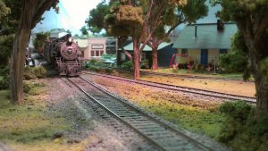

Chet has the sagebrush trees covered. I thought I would post some pics of an alternative method to sagebrush as trunk material. These trees were made using Woodland Scenic armatures as a starting point and then adding the dried plant material from a Scenic Express SuperTree kit. The real plant name is TELOXYS ARISTATA according to some others who have researched it (http://www.botanicalgarden.ubc.ca/forums/showthread.php?t=5052). I use Hobb-e-tac to glue the branches to the armature. Then spray with my favorite adhesive spray and sprinkle with the desired ground cover/leaf flake and you're done. Here is some trees I made this afternoon. One other tip I can share, I stole my wife's old coffee grinder and use it to grind course ground foam into finer texture - or - use the grinder to pulverize dried clay clumps I've taken from the woods/yard near the house. Since I'm modeling lines from my area, I am able to use earth/dirt as an exact match. It's very helpful to be able to get a very fine texture.
[/url]
Untitled by BillBPA1, on Flickr[/IMG]
They are randomly stuck in some extruded foam awaiting placement on the layout.
