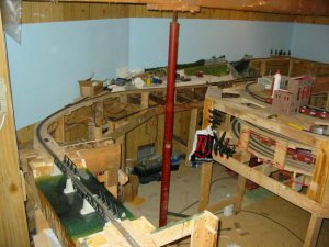

Ah! Shoot, well all the construction photos are still on a hard drive in a much older computer along with many others that will be recovered some day. Here are a couple salvaged from a forgotten Photo bucket site
Note the size of the hinges as the gate was very heavy and it swung outward. This unit worked very well. If the gate was open no train could approach from either side of the bridges. There were no derailments and the cuts through the track were on an angle, thus there was always a solid piece of track for the wheel sets (no derailments because of misaligned gaps in a piece of track. The wooden part of the bridge is still down stairs but won't be for long so I can still get the cut angles if anyone is interested. Anything else would have to be from memory.
