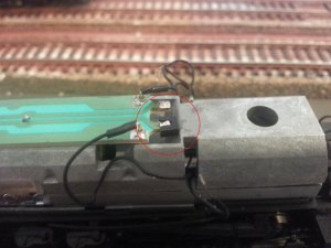

So... this all started because the headlight had quit working... Immaterial, I thought, once the whole thing exploded on me. As it turns out, failing to recognize/mention this was at the core.
When I pulled off the shell, I found the headlight leads were attached by putting the wire through a hole in the circuit board, and mashing on a plastic "shoe" to hold them in place. Like this:
Since the headlight is on the leading engine which swivels, but the connection is on the circuit board which is 'fixed' to the back of the loco, these wires move as the lead engine swivels. Over time, one had pulled out from under the shoe.
I 'tsked' at the bad engineering, and soldered the wires in place solidly. Went to put the shoes back on just 'why not' but they no longer fit over the solder. I tossed them in my useless bits pile.

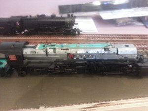

Let's take a look at the loco while I was doing this:

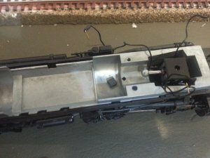

Shell off. You can see there's a circuit board on top (held on by one screw) and the motor, flywheels and transmission are sandwiched within two weights - an upper and a lower. The upper weight is held on by two screws.
One key thing I did several times during the process was take off the upper weight so I could test the motor and transmission by applying jumpers from my benchtop 12v power supply right to the motor terminals. As previously stated, it ran fine. Turned the wheels, no binding. If I set it on the workbench and applied power... away it would go.

Okay... pull it all apart. I'd suspect I mismounted the motor or something, but I'd never actually removed it. Maybe while I was running it with the top weight off it misaligned??? Okay, rip it ALL apart. Guess what I found? This:
One of those damned little 'shoes' had found its way under one of the flywheels. I could have sworn I threw 'em both in the trash pile, but I guess not... When I took the top shell off and there was plenty of 'wiggle' room, it didn't matter: the motor ran, the transmission ran, the wheels turned. When I tightened the screws back down, it bound up that flywheel against that plastic bit and 'no-go'...
