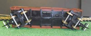

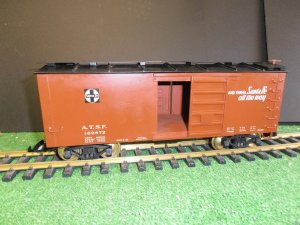

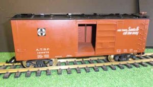

Unknown Manufacturer - Brass G Scale Freight Car
I am new at G Scale. I've inherited a collection of trains from an old friend and would like to start working with these.
The collection is quite an assortment. I thought I'd pick the type/maker I like best and stick with that.
I have some, that I can't find the maker for . . . pictures are above for one of the cars.
This car appears to have a brass roof and is made of metal (maybe brass?).
I was told the bottom has been sand cast -- it's numbered 100-20
Can anyone help me find who made this car? I have a few like this, and think this might be the best for outside.
It appears to be G Scale, fits on the track.
Thanks
