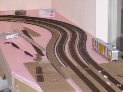

Sorry, I've been focused on trying to get my house built, so I haven't been checking in much lately. Yes, I'm aware that the Walthers track is Shinohara. I don't like the Atlas flex because the tie and spike details are too clunky for my taste. I am well versed in bending MicroEngineering as I used it on my last layout (see photo). I've never seen any of the Walthers track in person; thus the reason for my question. From the replies, I think I can feel comfortable ordering the Walthers flex track to save myself some money as I purchase supplies to start the new layout.
