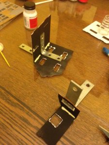

Thanks for the tips all! Hope I can return the favor. I find these little brackets come in handy when trying to square stuff up. IMG_0246.JPG
