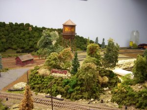

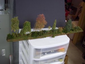

I did a scenic background using individual Scenic Express trees to hide some trackage. The trees are planted on a piece of foam and is removable. Finished Scenic Express trees are planted in heavy groupings in other areas of the layout.
The trees are simple to make. Chet is correct that these trees will make excellent Aspen or Birch trees.

Forgot to show a couple of photos of the Scenic Express trees in the background to hide trackage. The areas are not completed in the photos.
Thanks.
Greg
