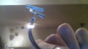

WIN_20160129_082037.JPGAtlas makes em and I have not actually used any yet! The wire is 18 ga and are each two feet long. I'm going to be using them this summer in the new track plan. If these ever get soldered it will just be a fine bead along the top edge(of the fishplate not the rail!) connecting the two pieces of rail along the side. As far from the drop wire as possible. ONLY if I'm having difficulties at that point. Solder will be my 'final fix' rather than an established construction 'technique'. I'm still an entire build and tear down away from STARTING a "permanent" layout!
