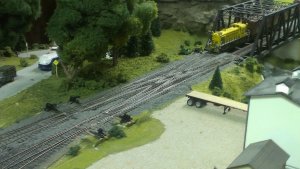

Doesn't sound right to me.I have two double crossovers and have no problems at all. In this photo, the locomotive is on the main line, and the other track is the yard lead. I do operate DC only but do have two walk around throttles and have no power feed through from one side to the other. This is a Shinohara (Walther) that has been in use for over 20 years.
I have another one in a yard on the other side of the layout and again, no problems like you are having.
I really didn't want to use a double crossover in either location, but due to the limited real estate, there wasn't much choice.
