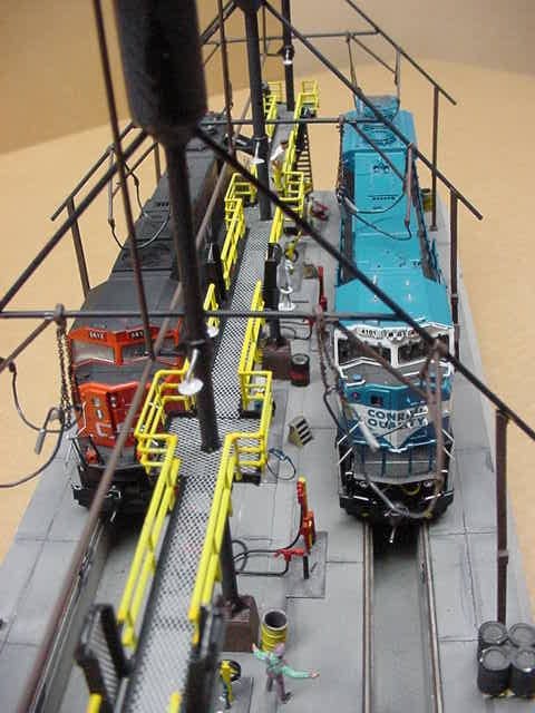

When I looked again at the diamond scale site I read this,...
"Our kit includes a Hydrocal cast platform directly mounted to a wood composition base, and is designed to be installed from beneath your layout The platform features two parallel pits with steps, and has been designed for laying rail without ties on the ledges above each pit. The pits were lighted by fluorescent lights immediately below the tracks. Our pit has been cast to receive grain of rice bulbs (not included in kit) should you desire to install lighting in your pit."
My platforms are NOT cast plaster, and do not have pits in them, ....Rather my concrete pads are plastic,...
So what might I have ??

  1. I do know that the 'paved' facility will likely be as long as that pictured.
  2. I do know that I do NOT have any room for large fuel storage tanks anywhere near this facility.
  3. I am considering having some sort of 'holding tank' for fuel between the incoming 2 tracks that might allow for a 'most urgent / immediately available need', that itself would be fueled by piped-in fuel from a remote tank supply. I have a number of those cornerstone piping kits that could be configured to represent fuel coming into that holding tank, then fuel sent down the length of the fueling platform.
  4. I'm debating whether or not to have any inspection pits beneath the tracks as shown on the Diamond Scale model
  5. I think I would like to have the 4 small sanding tanks and arms similar to the DS model.
There will be NO tall cars (perhaps no freight cars at all) run thru these 2 tracks,...ONLY diesel locomotives, and perhaps an aux fuel car like that CSX one.
