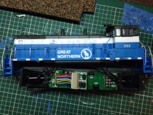

I would say yes he meant DC. I don't see anything in what you have related that the seller said or implied it was a DCC locomotive. Does it say DCC on the box?

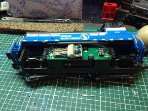

Nope, no DCC there. That circuit board is basically diodes for directional lighting.
The good news is there are two options for adding a plug and play decoder. The 8-pin NMRA plug or replace the directional lighting board with a decoder. The only thing I would be worried about would be the decoder not burning out the light bulbs. Athearn Genesis units use 1.5V bulbs. Is it Genesis?

That is Athearn's lighting board, fitted to both their Ready To Roll line (DCC Ready) and also their Genesis line (DCC Ready). It has the 8 pin socket (the black one) and the 9 pin socket for the "Quick plug" option. The Decoder I use in these engines is the NCE D13SRJ 9 pin, non-sound, which replaces that small circuit board you can see attached to the colored wires. There is no need to change the light bulbs with that decoder. Here is a Ytube video link https://www.youtube.com/watch?v=dfRnHFneI_E There are several of these on Ytube.
The term "DCC ready" is a somewhat used and abused description. Technically it's possible to install DCC decoders into any 12Volt DC loco. The main physical requirement is that the motor must be electrically isolated (insulated) from the frame. Earlier models such as Athearn's Blue Box ones used the frame as part of the circuit supplying current to the motor and had to be modified. Later ones, such as you have are constructed that way.
There's also LokSound Select, if you want sound. That's a board from ESU that totally replaces the stock Athearn board, and it does require basic soldering skills. It'd be a bit of decoder tetris to get the speaker to fit in there, but other than that it would work in theory. I do not recommend using the 8 pin plug; it's too much hassle to fit a decoder in there with that board and the bulky 9 pin JST plug, I know from experience. If you can solder, replace the entire board. If you can't, use something that's small and has a 9 pin JST plug on the board.
