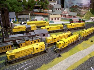

All of these locomotives started out as undecorated units. After painting them, they were all hand lettered, number by number, adn letter by letter. (Can't afford custom decals) I may apply two to three numbers or letters at a time which helps keep everything straight. When all of the decals have dried, make sure you carefully apply Solviset, ar another brand of decal setting solution, which will soften the decals allowing them to settle over any louvers or car body doors. When the decals are dry again, I then would overspray the entire body shell after any details such as grab irons or such have been painted. This will seal the decals so they won't come off. I haven't had any problem doing this. Most of these units are over 15 years old or older.
