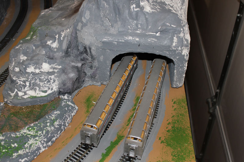

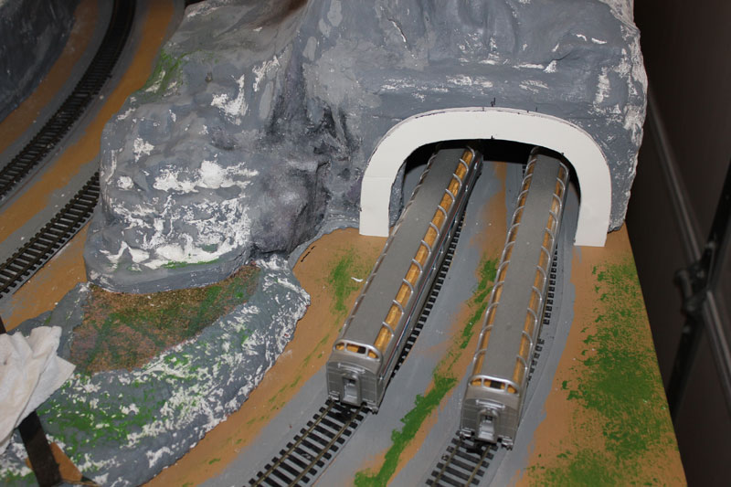

I have this:
and I have two choices...this one that I don't like but will be easier...
...or this one I think can look better but takes a little more work...
So my real problem, no matter which I use, is what to use for stone. I'd like to use a Pennsy style looking thing with something that looks like cut and fit rock with a keystone. So what material can I cut up to look like stone??
