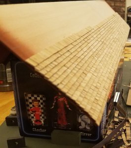

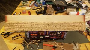

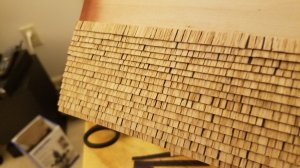

Sorry I haven't updated this thread. Here is the latest with shake shingle roof:
There has been a HUGE learning curve with this build. The original design called for fairly thin strips cut before placing on sub-roof. I have found that 1/4" to 5/8" is ideal for cutting, handling and aesthetics. More to come.
