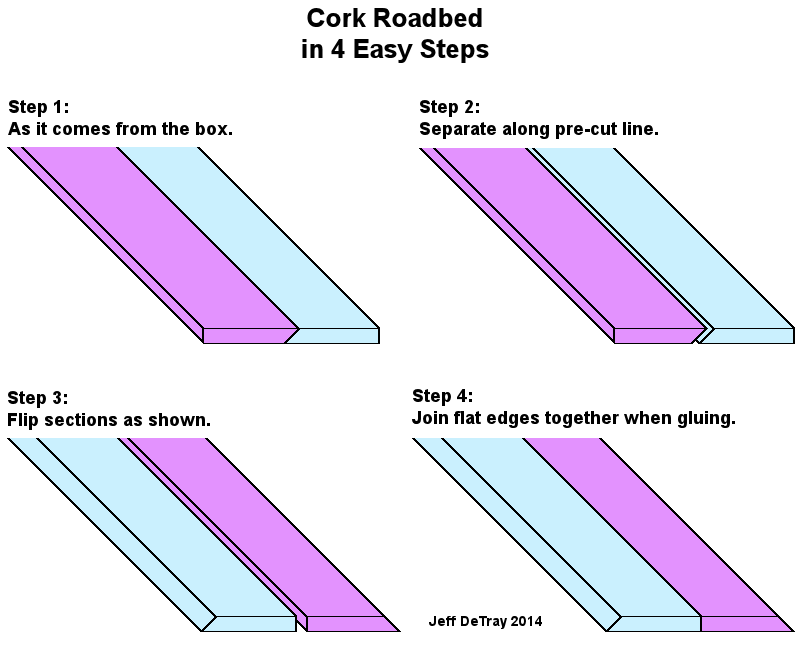

Here are a couple of illustrations regarding the use of cork roadbed.
As it comes from the manufacturer, the cork is partially split down the middle on an angle (Step 1). You can finish cutting it apart until you end up with two halves as shown in Step 2. You then re-orient the cork as shown in Step 3 before gluing down first one half and then the other half. The final configuration is shown in Step 4, where the profile of the cork creates a sloping edge on either side of the track, which helps to form the proper profile for the ballast you will add later.

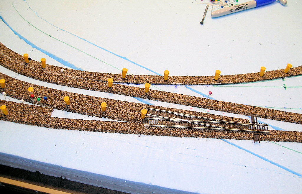

In the photo below, you can see how half of the cork roadbed is glued down and the glue allowed to cure before the second half is glued down. By gluing down only half of the cork at a time, it is easy to follow the curves of your track plan by positioning the flat edge of the cork against the center line of the track, as Iron Horseman describes above.
I use inexpensive latex caulk both for gluing cork to foam and for gluing track to cork.

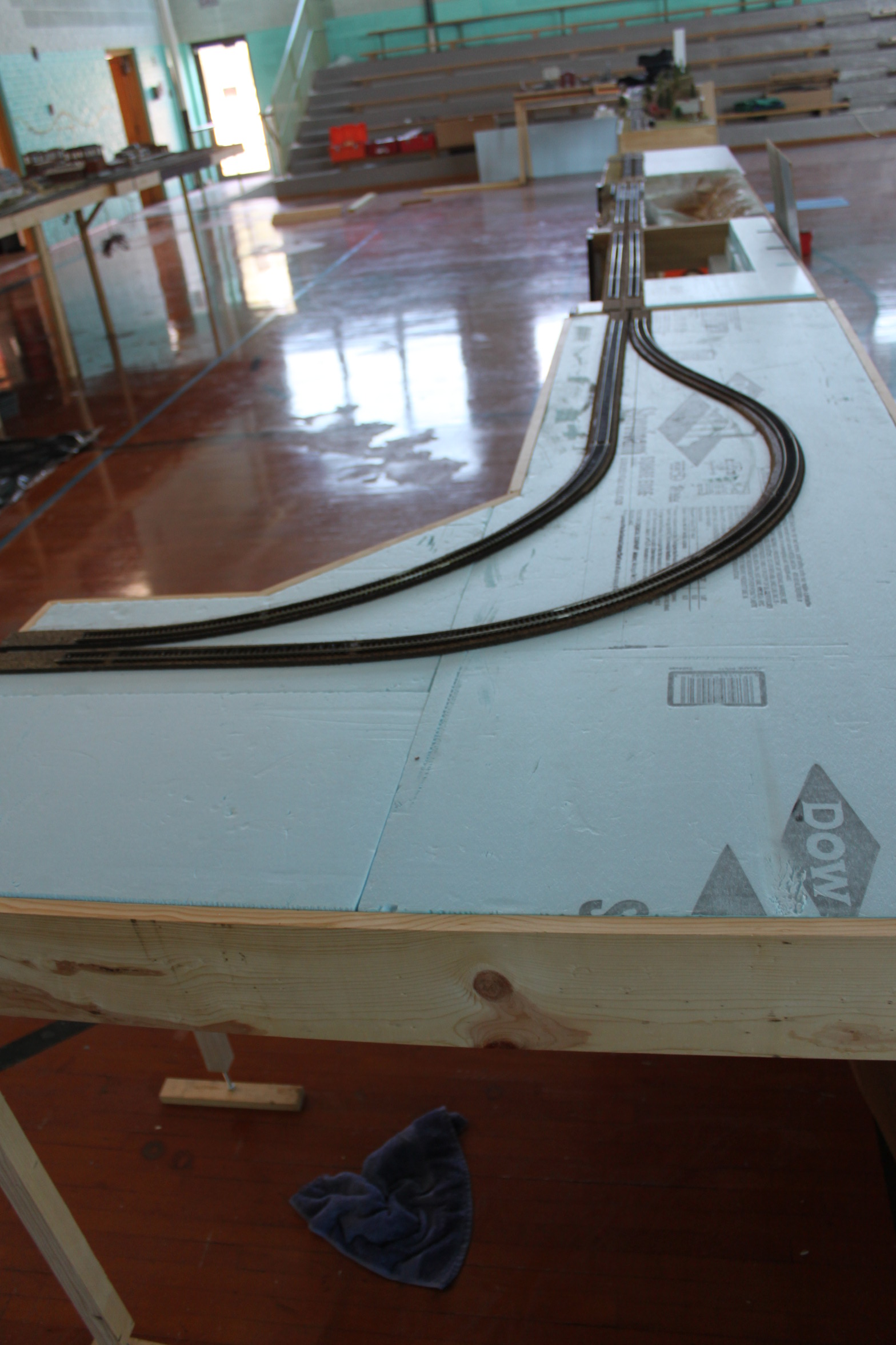

Do you mean a big sheet of foam over the whole thing or do you mean foam roadbed like Woodland Scenics? http://www.amazon.com/Woodland-Scen...s=woodland+scenics+roadbed&pebp=1419047103089
If you mean the large sheets of foam, I use it often. But always with roadbed.
