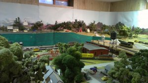

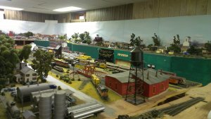

I built my layout in 8 foot sections in general. Some pieces were smaller in order to make everything fit. Most of my layout is along the wall.
The layout benchwork is made using 1x4's. I just used inch and a half sheet rock screws to join the sections together once the correct height alignment was done.
