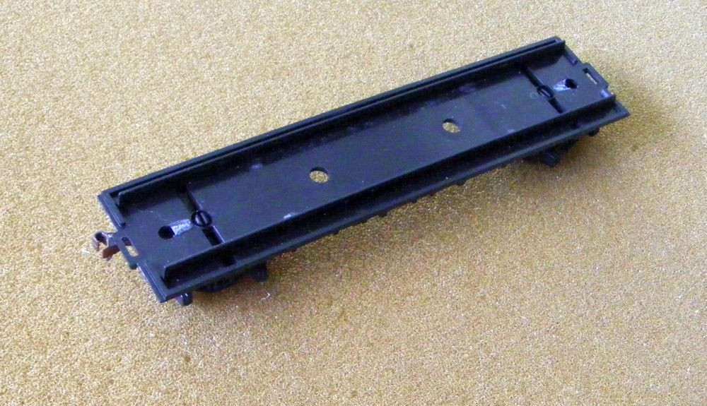

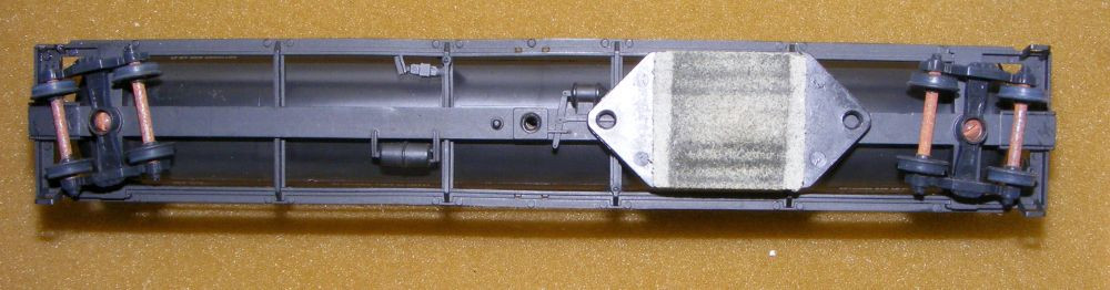

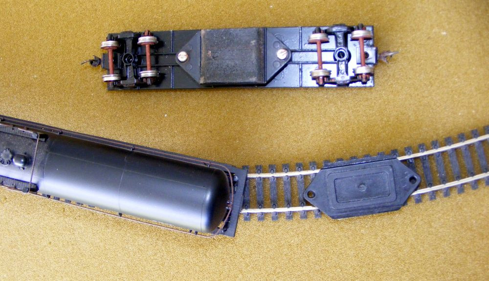

Looking to buy 1 or 2 old style Roco pad type cleaning cars. Don't even need the shells, ....just the frames and pads for some experimentation.
The bottoms would look like this,..

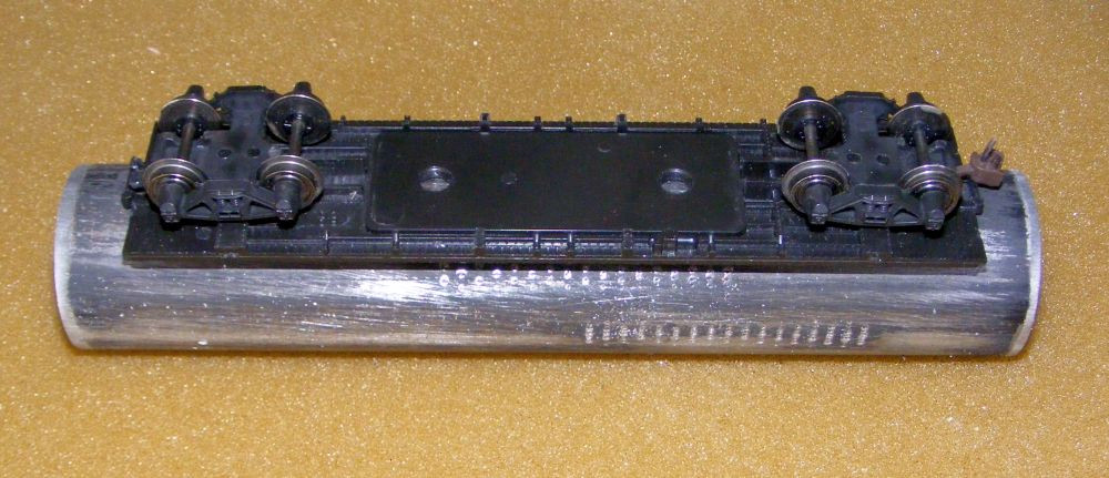

The choice could be for a number of 'pipes' (not tubes) with 1" inside diameter. Here I show plain steel pipe that can be bought in short lengths, and cut by your local Lowes store.

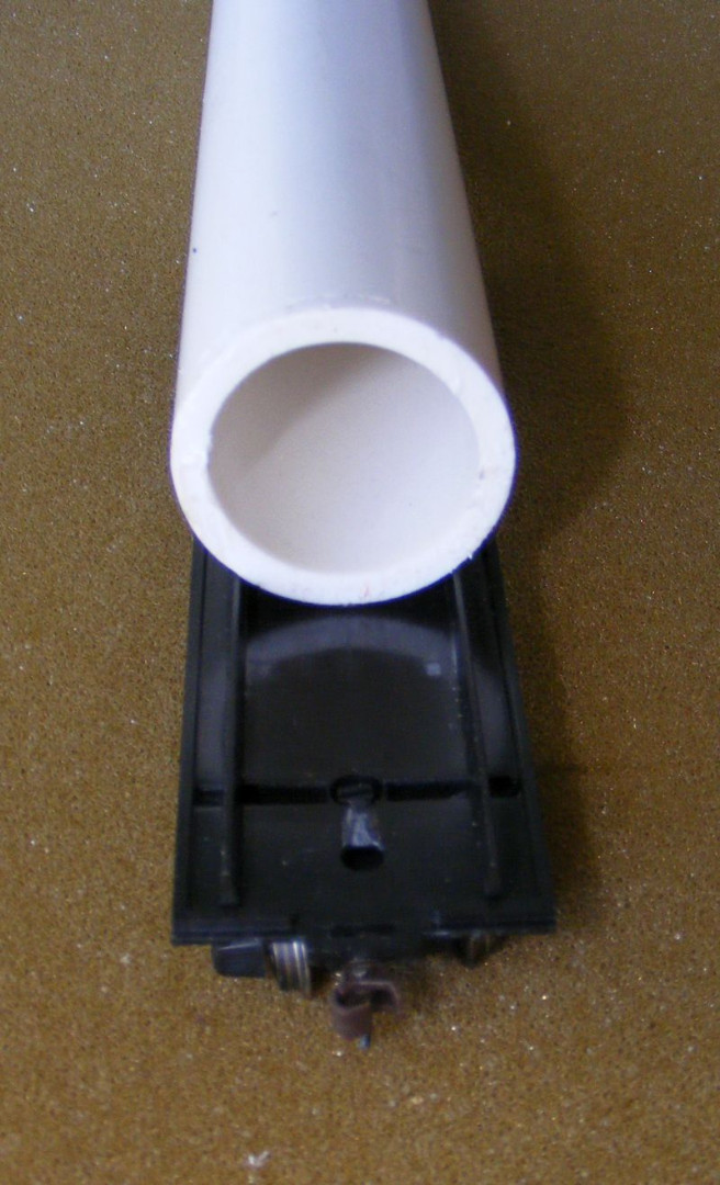

There is also a plastic pipe that I have experimented with, and appears to be fine in containing mineral spirits
I choose 1" diameter because it can be capped off at the end by a flush 'internal plug' of some 1" dia solid rod material of metal. plastic, or even clear acrylic (you would be able to see your fluid level).
The steel pipe obviously has the greatest weight, and certainly MS is not going to attack it.
That 1" dia pipe also fits very nicely into this frame of this Roco car.

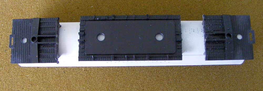

Since I am interested in making the cars overall length just a bit bigger than the Roco car, its frame could be be cut into 3 sections and spread down the length of the pipe, while retaining its proper truck alignment. I'm thinking a 7" length of pipe (1" less than the athearn tank car), with a truck spacing of 6 1/4".

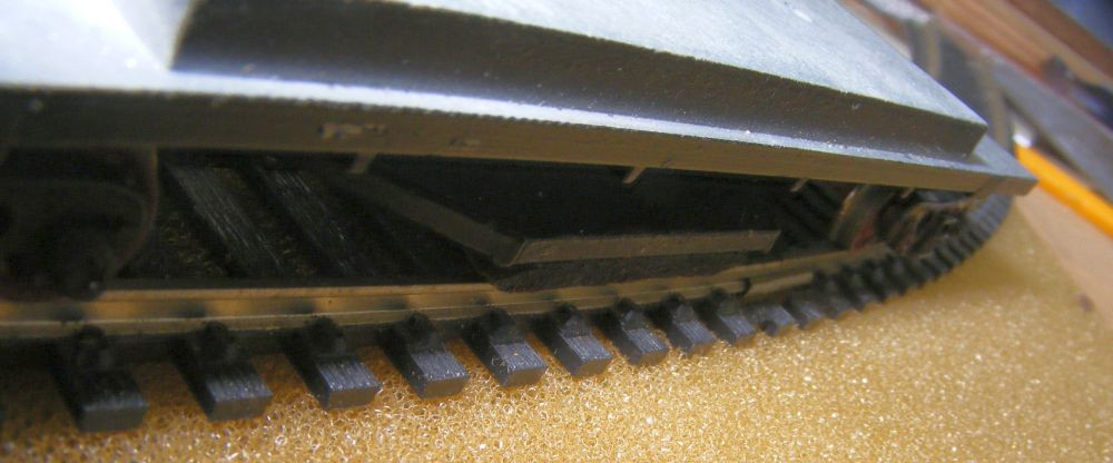

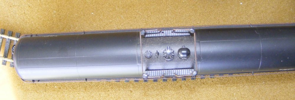

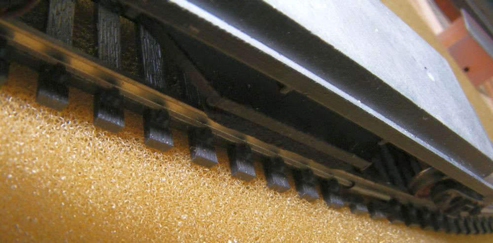

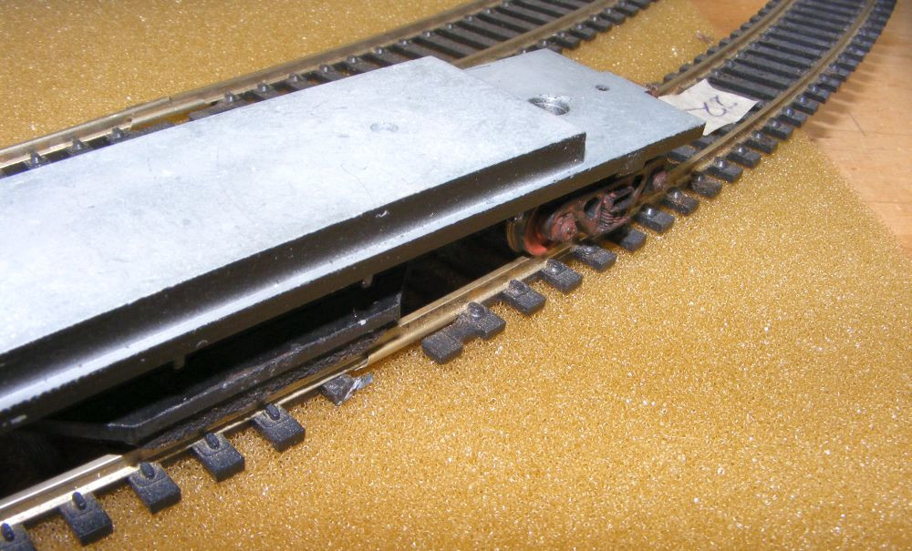

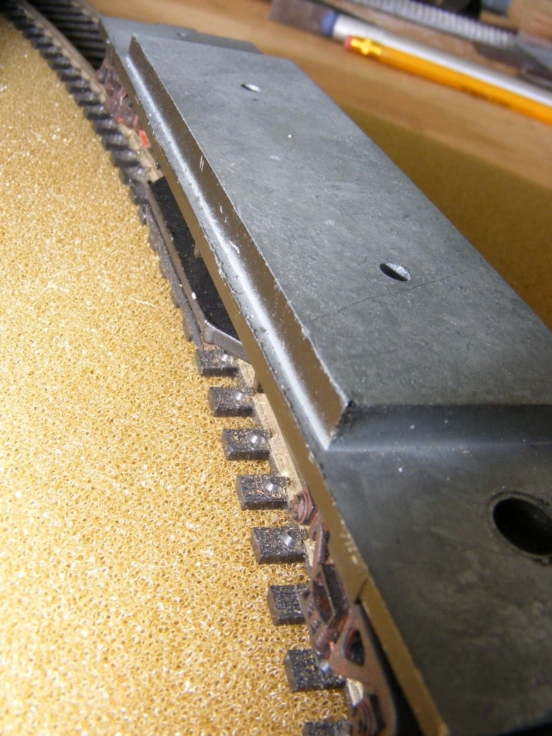

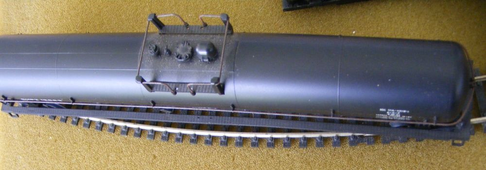

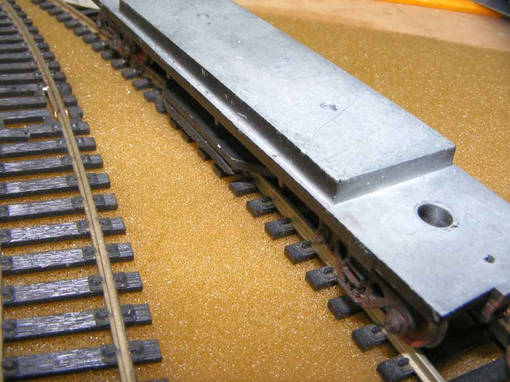

When I first started thinking of this alternative fluid dispensing car, I naturally gravitated to the longer car idea,..more fluid storage capacity. But the it was suggested that I look at the footprint of the pad on the rails while the cleaning car was in the curves.
Many of those existing cars had pads that work fine on straight tracks, but some questions arise with the contact (rubbing capability) on the outer rail of those curves.
I chose to also consider 18" & 22" curves since many modelers still need to to utilize these,...
Those skid pads could be made a little wider, and/or located toward a favored end rather than just in the center of the car,..

Steel Pipe Version first
First I had to clean of all those very sticky info tags and price tags, and check for smoothness,..

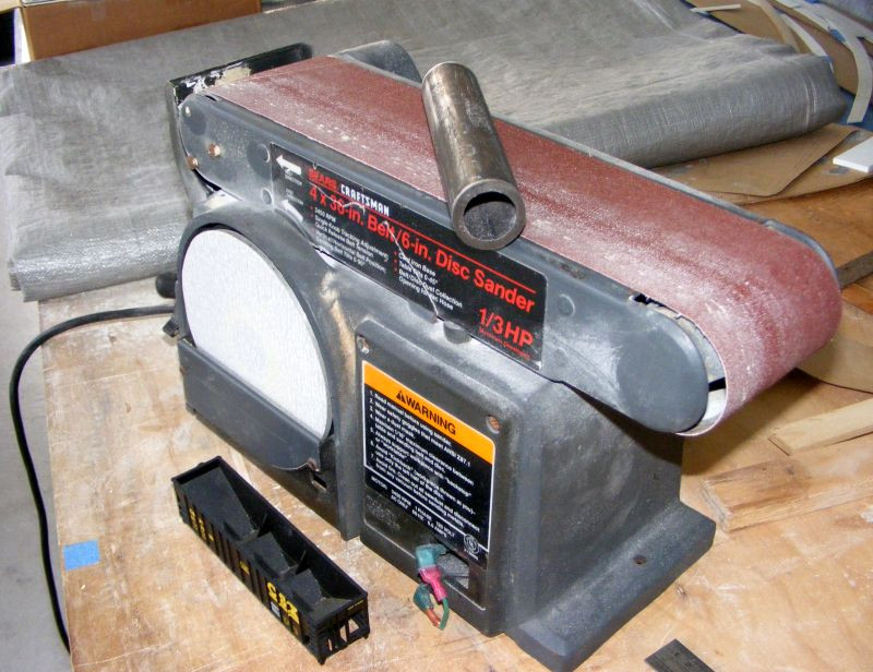

Then I wanted to clean up those ends that were left a little rough/uneven by the pipe cutter at Loews. So my trusty repaired belt sander to the rescue,.. (idea arose,...perhaps I could just glue flat ends on the pipe rather than finding a well fitting solid tube piece to insert in the end?) ... (and perhaps those ends might be glued on in such a manner as to be chiseled off if ever found necessary)
Test fitting,..
Now I decided I was going to prime paint them so I could more readily see markings I might be making on them,...light coloring of white,..
test fitting,..

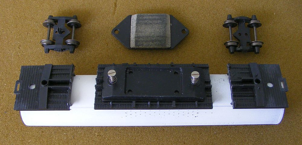

that pencil line along there tells me where to line up the 3 pieces I will be cutting the original frame into,..
Some notable items:
1) I have cut the original coupler pockets off of the trucks as I intend to mount body mounted coupler pockets.
2) I have retained the original metal wheels with their larger flanges (might be an asset with a track scrubbing car)
3) The spring pressures could be increased as the overall cars weight would handle it.
4) The original track scrubbing pad had a small recess in it that could act as a secondary fluid recess that feeds thru a small hole at its center to keep the pad wet,..
Pretty reasonable investment so far. Just need to add a needle valve and fluid fill valve.
