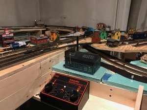

This is the area were I had the most problems with curves in the track, that double track curve, particularly the inner curve just being a bit too tight.
There was a particular loco I would use to try and find derailment prone areas. It is a six axle diesel loco with small flanges on its wheels. This loco could find difficult spots as it tended to pivot on two of the three axles on any one truck, and thus derail the 3rd axel's wheels

Yes, that area in your image is where the issue was. It works now, curve is a bit tighter than I would of liked, but it's not going to be visible.
The layout is progressing well. I've got a bus feeder line run around the mainline and in the yard, and feeders soldered to the track and connected to the bus. Some scenery is in, with the next stage being power to the turnouts. I just need to get some spring loaded, SPDT switches for that.
