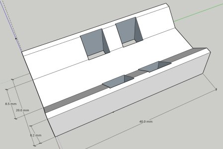

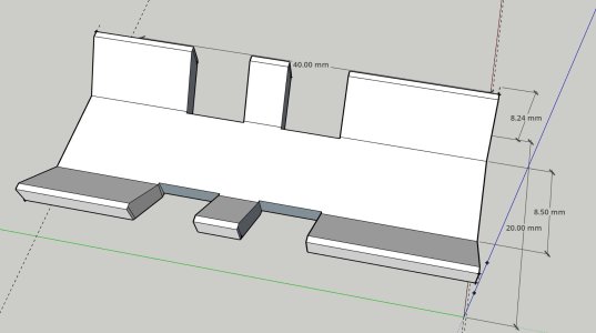

I also remotored my Athearn BB's with the Kato motor. DD35, U33C and an Genesis SD70. One of the advantages is that not only are they much quieter, they also draw less amps and my motors came with the plastic motor mounts and fly wheels. All I had to do was buy the circuit board from Kato and it became DCC friendly. I 3D printed the motor mount and glued it all in. The DD35 had the biggest effect as those two motors were power hogs.
Motor mounts for DD35 and Genesis SD70M. No modification needed to the Kato motor plastic mounts. No cutting or welding required. :)

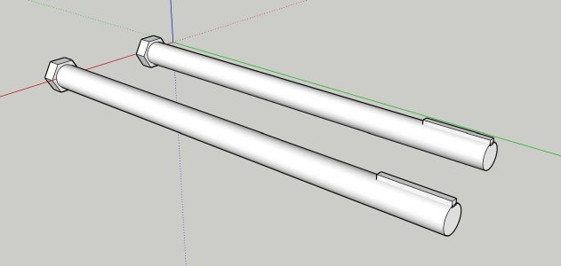

One thing that I found out during these projects is how similar the Kato, Lifelike, Athearn mechanisms are. The flywheels all use the same size hex hole for the drive shafts. The biggest differences encountered were the drive shaft design. Some used a sliding collar with a keyed shaft and others just went with the simple shaft with hex on one end and dogbone on the other. It was easier to design and print the keyed shaft one... Went to A-line for the dogbone shafts.
