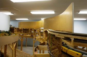

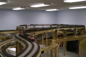

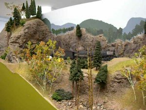

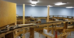

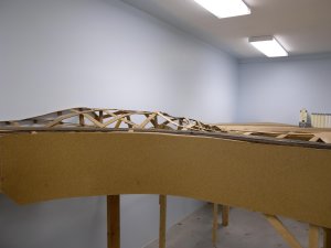

This monstrosity is in a 30ft x 50ft metal building, purposely built for the MRR. Been working on it for about 8 years now. I lost a bunch of build photos along the way but saved a few. It is a DC outfit, with 150+ locos it will be some time before I get into that. I set it up with enough blocks and power to run all the units I want on any train, and can run more trains than I can keep track of LOL. All power is Athearn or Athearn clones. Why? Cause thats what I started with, 30+ years ago LOL, they still work just fine. I still enjoy building, detailing and painting them.
Anyway a couple photos along the way.
Please post your comments and questions.

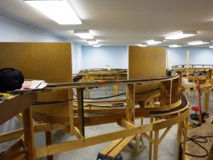

This freelance MRR starts off at 54" above the floor climbs to 74" at the entry door. One direction out of the main yard (timetable East) is a 1.5% ruling grade but is fairly long like 200' to the summit Quanah. The other direction starts off at 1.5% but levels for a bit then goes into a 2 1/2% climb to the summit all in all around 200' that way too. I will never get done with it.. The main yard will hold around 300 cars, Quanah around 75 cars, other yards and sidings off the main will hold 40 cars total. 2 staging yards holding 200 cars each. main yard has an operating hump, so yea it is kinda big I guess. I know that I will never take on a project like this again, not this complicated anyway, next time if there is one will be single track main with sidings and easier to access staging yards. we usually run 50-65 cars on a train probably 40 ft in length is average. 20-35 car locals. A couple reversing loops to keep stuff even more complicated to dispatch.
I am soooo lucky to be fortunate enough to build something like this once in my life, but I think once is enough :o.

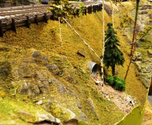

This shows a culvert I made from a plastic 3/4 inch plastic pipe, cut in half the threads rounded, the hard shell scenery proved to be too messy and laborious for the size of the project I was doing so I went with a resin paper over cardboard webbing system. Very fast and very clean scenery BTW. This fill is using the paper method.

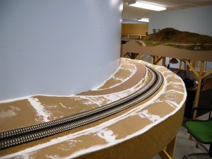

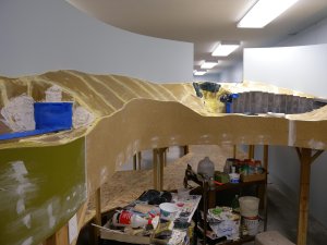

This shows the resin paper down with cheap (very cheap) painter caulk applied liberally at the seams. The next step is to paint full strength water based glue over the paper, I used Elmers carpenter glue, as it resists subsequent water based applications a little better than the White glue does. This is very inexpensive and fast.00018.jpg

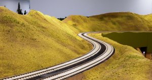

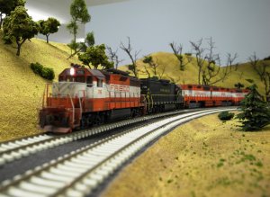

After that dries a little or a lot I painted on dirt colored latex paints, while still wet sprinkled the various ground foams and screened dirt, added brush trees and stuff. The dead tress in the background, were meant to show where a fire was in the past, and vegetation beginning to grow back. Still need to ballast that section of track.

TOM- Your fill scene with the culvert is very good. Just the right amount of brush and debris showing.
You're going to have to elaborate a little more on the resin paper for me. I have not heard of this: Cost? Where do you get it? and How sturdy is it?
Will it hold up to Grandkids? Probably not ... A manhole cover has a tough time!
Great looking layout Tom!
Love that culvert scene too, I just finished my styrofoam base where I'll be doing a similar scene.

Roofintrash, Thanks, that culvert was those cheap grey plastic ones, i like cheap when it works, lol.
