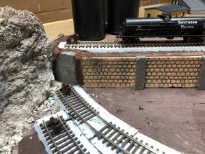

I made this "stone wall" with foam core. 1. Peeled off the paper on both sides of the foam, 2. Cut the foam into desired width and length,3. Score vertical and horizontal lines on the foam with a pencil, 4. "Pock mark" the foam by pushing wire brush bristles on to the face of the stone, 5. Paint the wall with dark brown paint, 6. Paint the scored lines with a gray or cement color, 7. Dry brush a light beige paint on the "stones" in the wall creating the "mortar" affect between the stones in the wall. I added the cement columns in this photo by cutting/carving them out of green 3/4 insulation foam from Lowes. The hardest part of this process is getting the scored lines straight on the foam.

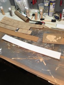

I made some stone block walls from 1/4-inch blue foam. I used a metal ruler to emboss the horizontal lines and a wide screwdriver blade to emboss the individual blocks. This was followed by painting and weathering. The photo below are test pieces for straight and curved walls.
